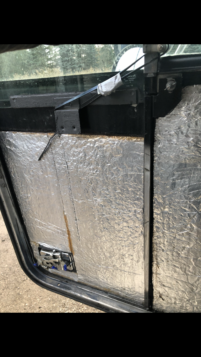

  8. Rideandrepair
    17,580
    56,948
    Aug 8, 2015
    I saw a Canadian once that had the inside of fenders sprayed on a new WS.His Boss didn’t want rocks putting stars in his paint. He was always picking rocks out of the insulation. Lol. It worked. I used the cheap Artic duct insulation from Lowe’s, in my doors.Poormans dynamat. Sprayed it with sound deadening undercoating first, and glue near seams, edges. It’s holding up. Not much room in there. Everythings new now, on doors. Still need to make some new thick inside door panels. Plan on also doing the floor, maybe 2 layers. Mainly for noise. Thick closed cell foam used on new cars works good if you have the room. Like to get some, it comes in all densities and thicknesses. Peel and stick. Put it under the dash, on firewall. My Truck is so loud inside. Need some good hood insulation, it’s all long gone. Rather not put anything on the outside firewall. But that would be best. Still not sure on roof. Lighter silver or white paint would be good. Rather not have to paint. I’m thinking a thick exterior insulation board with foil on at least one side, facing up, leaving an air gap for starters.
