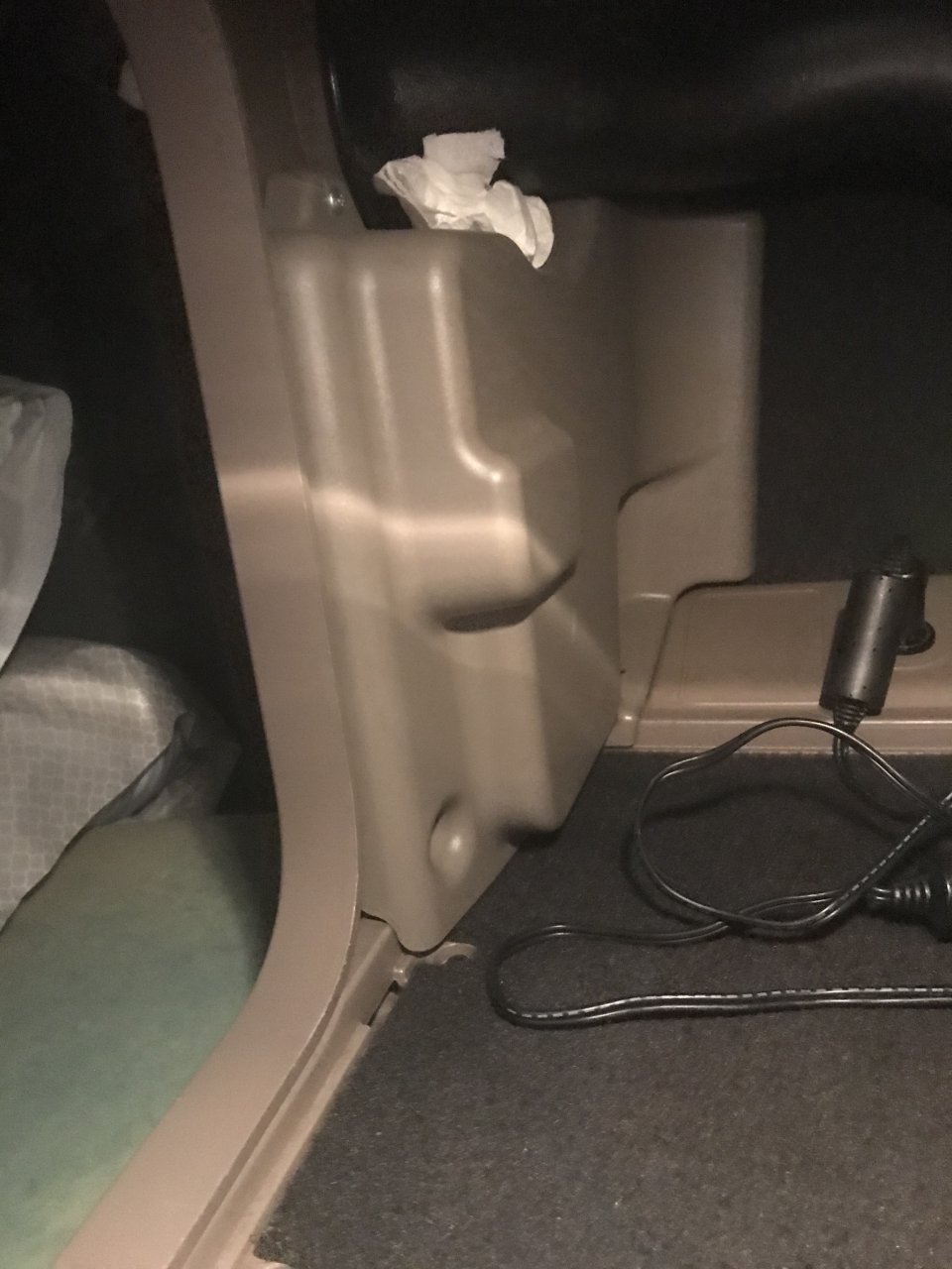

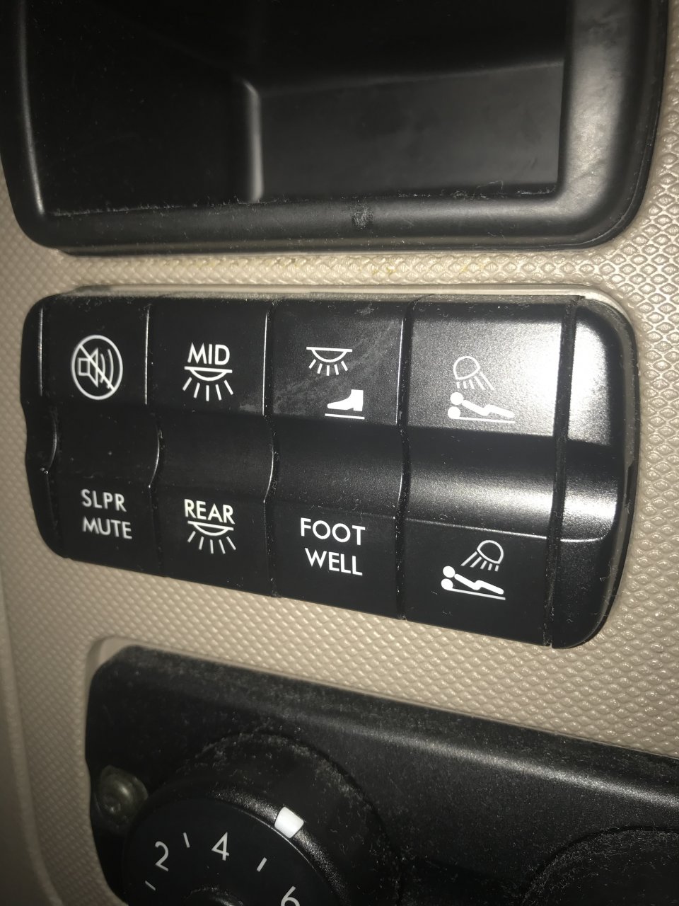

    9FB2F3E5-507F-4B9F-9572-FB377B515F33.jpeg 6B895694-10CC-4E17-BA52-2D3182A98DB5.jpeg if you run your ac alot in the south. the condensation from the duct will drip on the control panel. it will cause all sleeper lights, check engine light and no cruise. i block mine off with paper towels. i stuff some down in there too.
    Intothesunset Thanks this.

    those control panels are sams cabs. so is the one with the 4 way button.

    ohh o.k. I took out the control panel trying to find something like this I didn't see any sign coming from the AC
    But you think do I need to change the control panel keys the one you showing in the pic you think should work normal if I do . Or if I bring electronic cleaner spray should help
    truckdriver31 Thanks this.
  6. truckdriver31
    6,986
    8,340
    Sep 18, 2013
    clean it first

    I did the way you told me and now it's works perfect
    I just clean it by the electronic spray then put it back again
    Thank you I appreciate it

    you stuff with paper also

    I will . Winter time coming no AC ...LOL...
