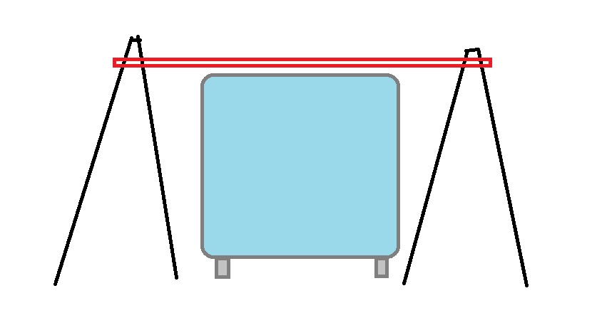

    does anyone know if it is safe to step on the cab ?!
    trying to install matching set of lights on my sleeper
    can probably reach from top of my cab without stepping on sleeper

    I was told the roof on the KW cab and sleeper are fiberglass and may flex enough to crack paint if not crack the fiberglass shell.
    I would suggest borrowing a pair of 8 to 10ft step ladders and a couple 2x6 12ft long and build a temporary scaffold over the hood. scaffold.jpg
    Siinman, pavrom and Speedy356 Thank this.

    I had this idea..

    Don't step or stand on any fiberglass...
    beastr 123 has the idea.
    I would not drill any holes in the cab as the vibrations may cause the whole to run.
    If ya do Flex-Seal works well.
    Stopped my cab marker lights from leaking when nothing else works.
    pavrom Thanks this.
