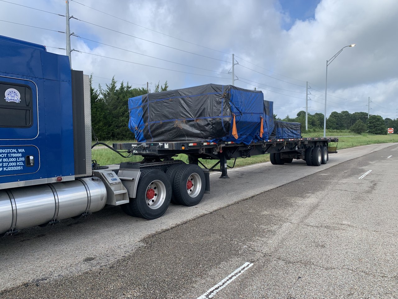

    My fifth wheel is pretty much always centered over the rear drive axle. Our long sliders are installed as far back as the factory will allow. Bobtail, full of fuel I’m actually overweight on my front axle. The only time I slide forward is if I’m loading heavy and need to put some weight on the front end. I can slide just ahead of center and split out at 13k/45k. EAA85BCD-7DFC-4630-AF4E-487684FC87DF.jpeg
    rides nice, never had any issue with the front end pushing, even with the 385 tires on the front end. In my option fifth wheel position has almost zero effect on maneuverability.
