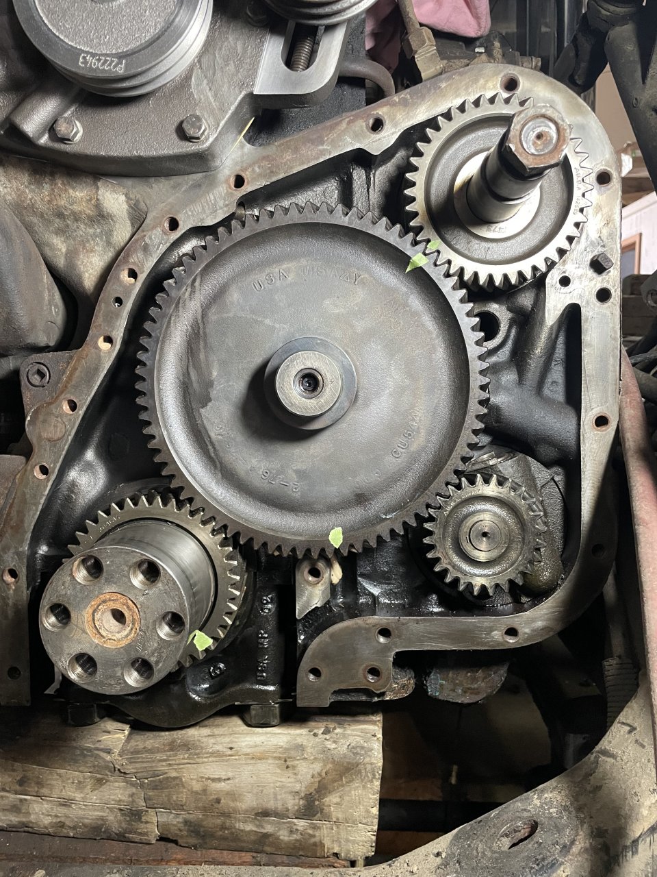

  3. mile marker 27
    mile marker 27 Road Train Member
    1,416
    1,739
    Dec 4, 2019
    When I installed the accessory drive the cam gear “0” and crank gear “0”, weren’t aligned. I don’t think those two can be aligned and have the hash marks on the cam gear line up with the punch marks on the accessory drive, all at the same time. This is where it sets now and I’ve put some pieces of green tape where “0’s”, hash marks and punch marks are. IMG_4155.jpeg

    Did you happen to find out anything on the timing procedure?

    On a big cam you set the accessory drive pulley to the "A" mark
    Set the timing mark on the compressor gear at 10:00, looking at it from the front
    Not sure if it's different on a small cam

    It will all line up....eventually. I forget how many revolutions it takes, but it's a bunch, to get them all to line up.
  7. mile marker 27
    1,416
    1,739
    Dec 4, 2019
    So I need to pull the accessory drive back off and rotate the engine?
  8. RocketScott
    RocketScott Medium Load Member
    579
    949
    Apr 10, 2013
    Kentucky
    No, it's lined up
    Not possible to have the crank and acccesory marks next to each other at the same time
    IH9300SBA Thanks this.

  10. IH9300SBA
    IH9300SBA Road Train Member
    2,431
    23,979
    Feb 26, 2021
    No....you're golden as is.
    They will all line up but it takes several dozen revolutions to do so.

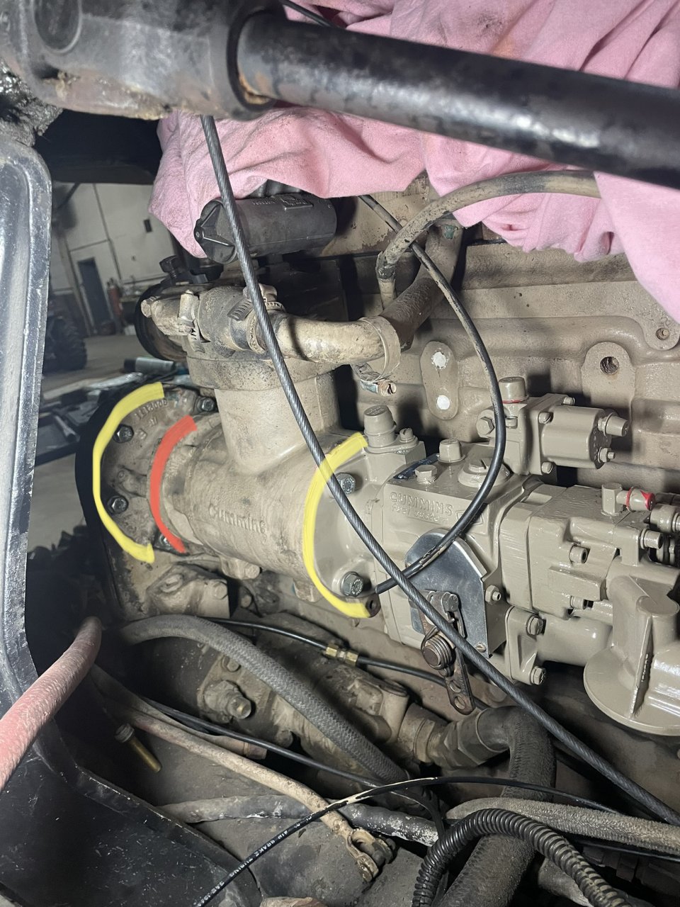

  11. mile marker 27
    1,416
    1,739
    Dec 4, 2019
    I never had the accessory drive took apart at the split they’re showing. My red mark shows where the manual says to time it and I took loose at the yellow marks. IMG_4150.jpeg
