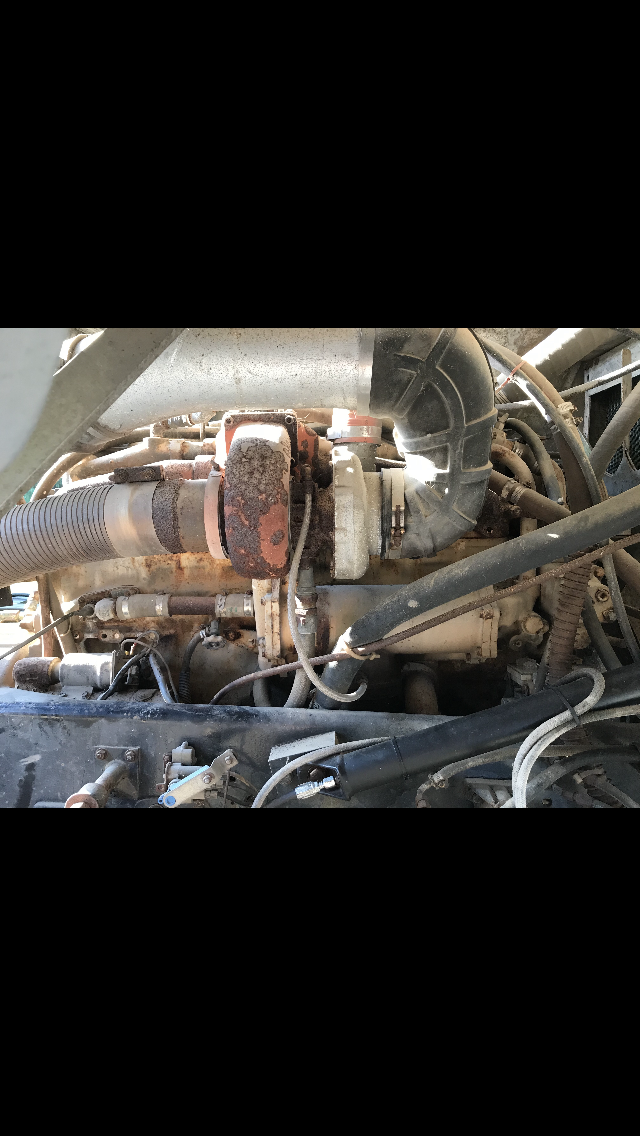

    Well he sent me a pic of the left side and I’ll try to have him get one of the right side tomorrow.

    1F5DAD1D-C49E-4F33-80B7-80CA030C5B8A.png Here’s the right side.

    According to quickserve that serial # is an nta 370

    Looks like a NTC 350 oil cooler and waterpump. The NTA’s 370,400,420 had unique waterpumps lower on the rightside and the oil coolers had a cast cone shape cover on the oil filter that stood vertical on the front of the cooler. Could have been converted from an NTA long ago but those parts to do it are not around anymore.
