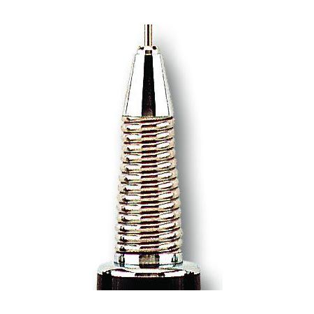

    anyone know where to purchase the small antenna spring that goes above the coil? Think Wilson coil style. I'm not talking about the spring that is mounted between the mount and the shaft. I've seen another brand antenna that comes with that small spring for the whip but I wasn't sure if you could purchase it separately. I'm in a transfer dump and I'm in the trees A LOT.

    Hustler makes an antenna with the spring like that.

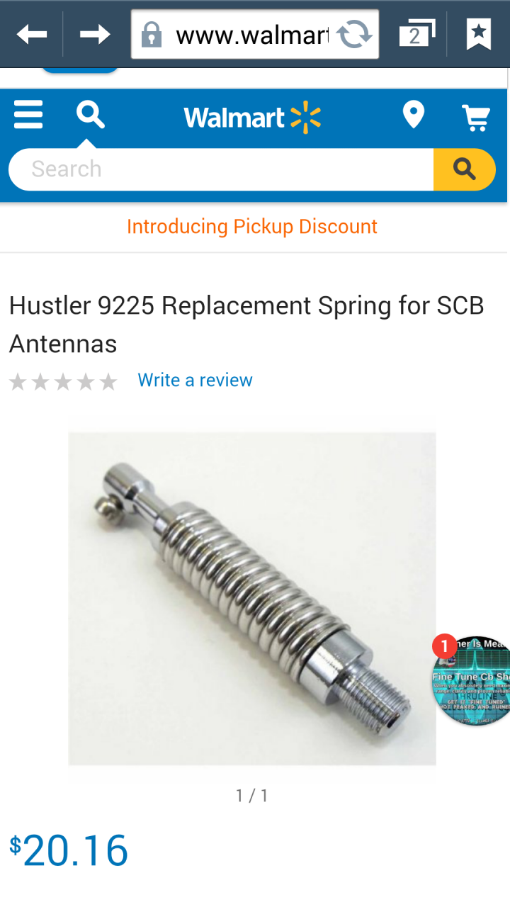

    20 bucks on Walmart's website

    Thank you. Hmm I wonder if that would work with a Wilson 2000. Or I need to just let it go... those whips are only $10 to replace. I've got a 3" spring between the mount and shaft.

    Wont work on a wilson ant. The coil is male threaded. I tried this with mine and they where 1/4-20 or maybe 5/16". I cant remember plus I had to make the spring hole bigger for the whip and it sent the SWR all outa whack so I just took them back off.

    Ok I remembered and its 5/16-24 threads. So I guess if you got springs and whips to fit the springs you might be able to set them up right.
