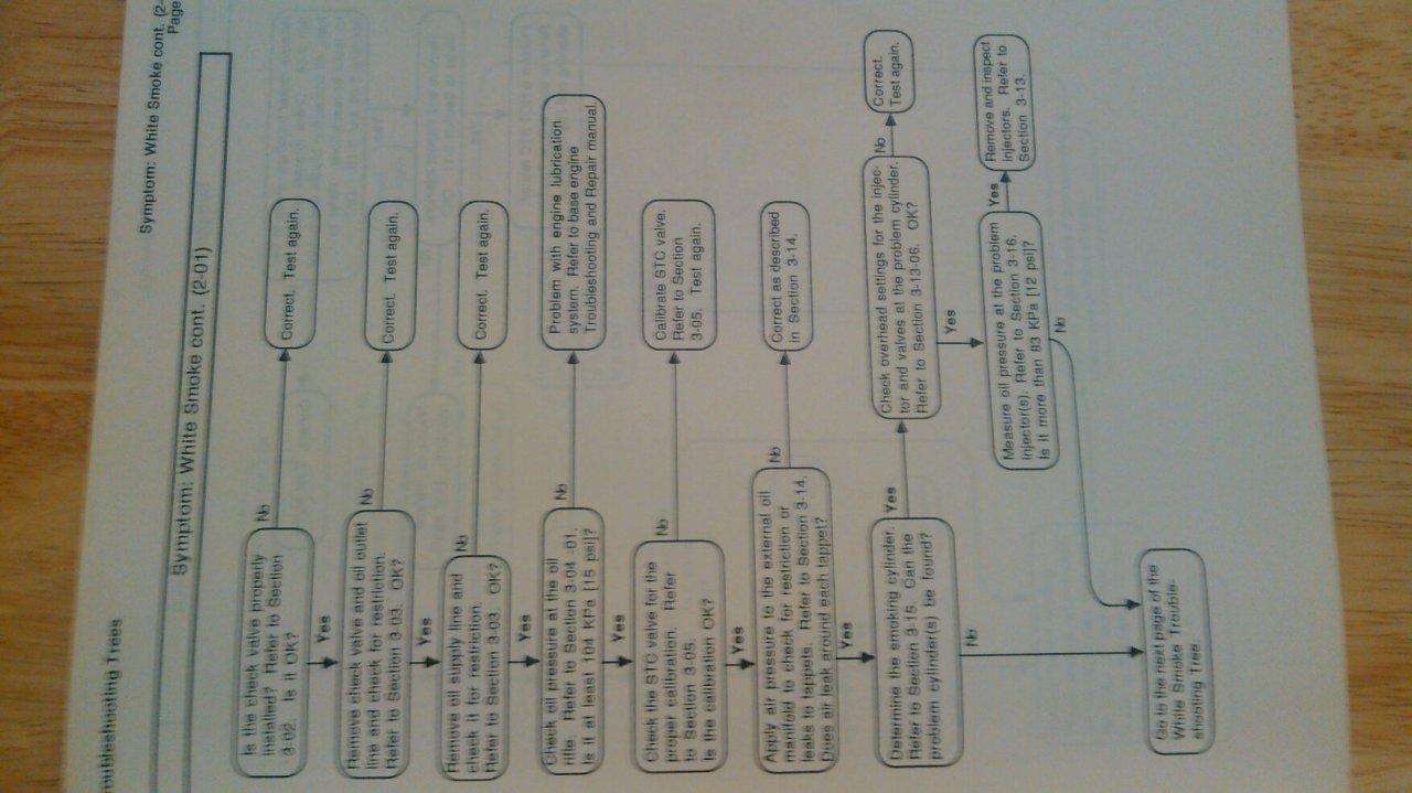

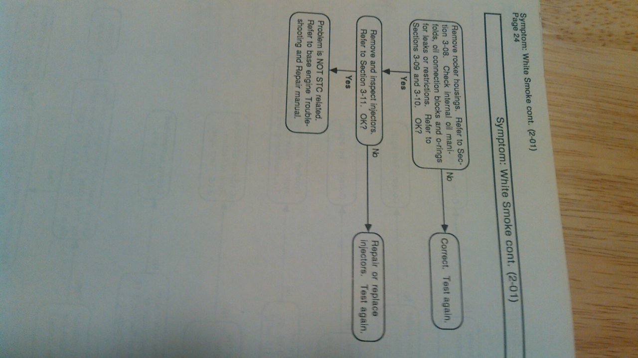

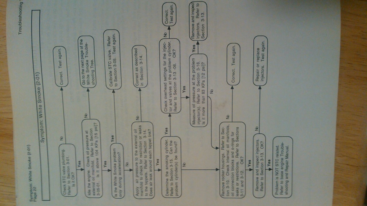

If the engine seems to run fine on the road & smokes, runs rough at idle i'd focus on the stc system. The stc valve supplies oil to the overhead at idle, light load conditions. An oil leak in the overhead can cause the engine run as you describe as some or all of the injectors stay in normal time. The plastic oil jumpers beneath injectors are prone to failure, there's a plug that blows out causing a huge leak. I'd run it with the covers off & see if anything shows up.
Outer base method is the way to set the overhead & Box Car is correct that the stc pressure should be removed prior to adjusting. Cap off the signal line to the stc valve at the shut down solenoid, connect regulated air to the stc valve control port & switch the valve into normal time while the engine idles. While in normal time at idle the engine will smoke, run rough & be very quiet. The injector adjustment varies depending on the cpl should be 90 inlb but I can double check on Monday.BoxCarKidd Thanks this. -
