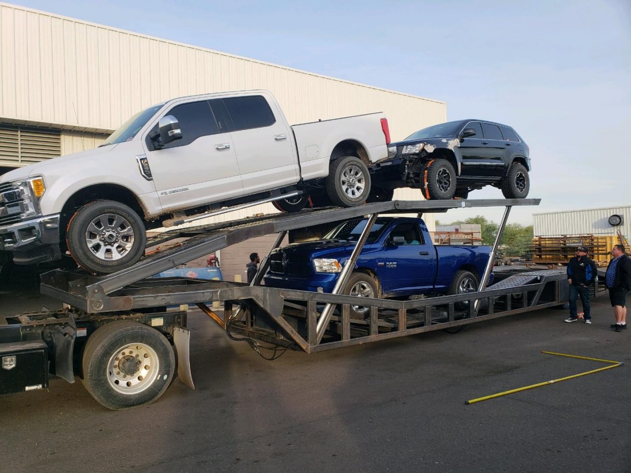

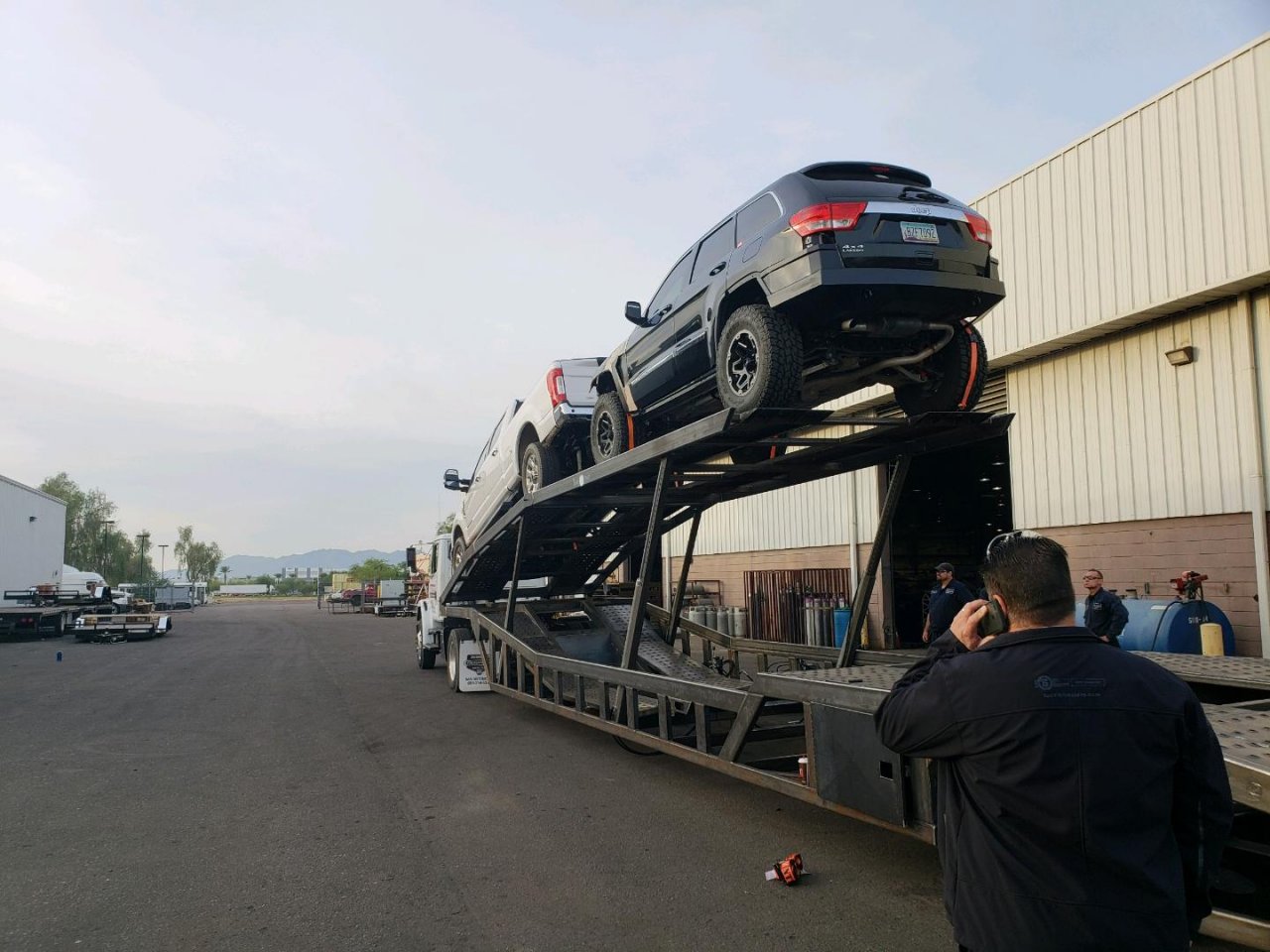

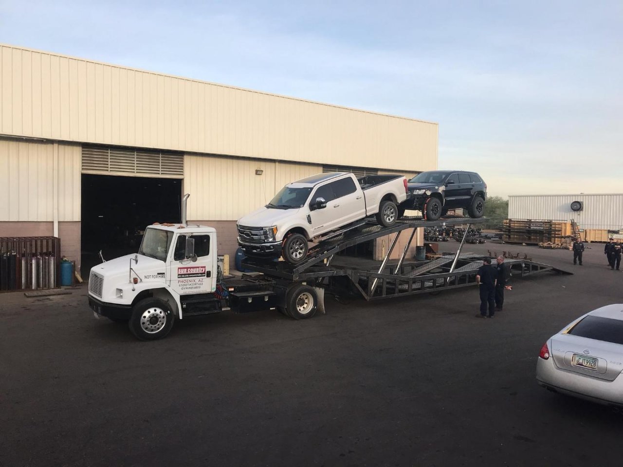

    Since my 3 axle stinger deal was a bust, and I already had some build slot time, I decided to dust off some trailer prints that I had drawn up about 4 years ago, they should have it in paint soon, so I guess I'll be packing my bags for Phoenix next week,,,,,,,, Never quit pushing that envelope!!!! 6322-MMS-.jpg 6323-MMS-.jpg 2018110195001.jpg

    Is it a 5 or a 6 car? I can already see its much more flexible than the standard sun country 5

    It's just a five car, but I was trying to do away with the front posts on the std 5 car, as the front posts are a pain if you are hauling buses or wide body vans, plus you can only get a real small car up under the front deck, unless you hang that top front car WAY off the front deck, I am trying to do 5 vehicles with NO overhang on either end. That is the real purpose of it.

    Well cant wait to see it loaded.. did you design the entire trailer? I see pieces of the original design
    KANSAS TRANSIT Thanks this.
  11. KANSAS TRANSIT
    KANSAS TRANSIT Road Train Member
    4,080
    6,845
    Jul 28, 2011
    Glasco,Ks.
    Right after I bought all my 4 car trailers I took measurements, drew it up and sent it to SC. The trailer is all SC from the wheels back, wheels forward is what I drew up, but of course it has many SC overtones, "Don't fix what ain't broke"!
