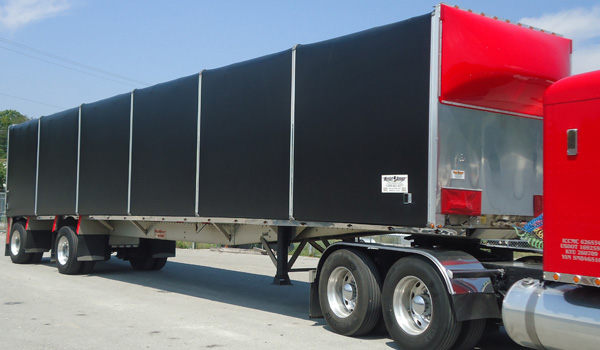

  10. aiwiron
    aiwiron Road Train Member
    5,927
    5,228
    Aug 24, 2011
    Sunny Tampa Florida
    Here is my definition of a Conestoga wagon.
    Years ago the double drop trailers with side kits were sometimes called the same thing.
    Mattchu and windsmith Thank this.
