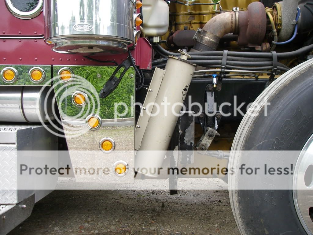

    My system cost me about $200, I bought the GCF2 housing w/ filters off ebay years ago for $150. It was a military take off, the other 50 I spent at a speed shop on AN fittings and braided hose. I plumbed it myself w/ a ball valve for easy sampling. I don't go for the GCF marketing but, with my relatively small investment I know I'm saving money. My housing is one of the old ones that say "the original paper towel filter" on it:
