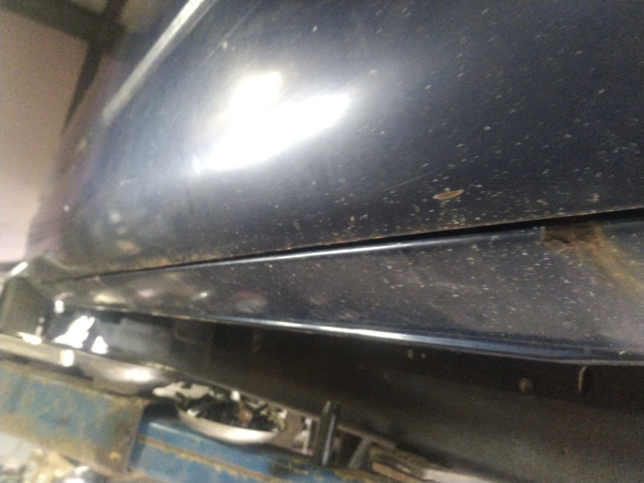

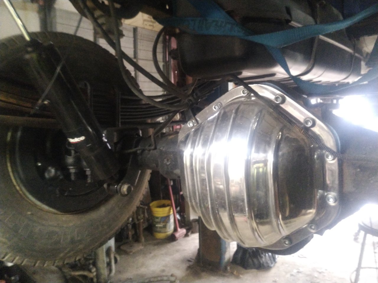

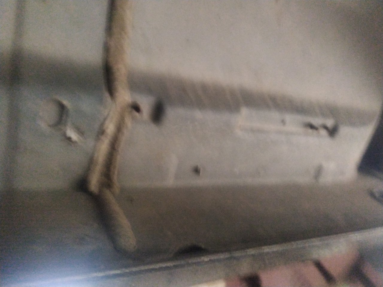

    Today I get the bell housing off, that's where I stopped last night,
    and remove the incorrect clutch.
    1st picture is looking up at floor and inside rocker panel.
    Still has the primer from GM paint shop with NO rust.
    Cab floor is "not even a little red surface rust" clean primer.
    Unreal; especially for a rust belt salt spewing state like Pa.
    2nd picture is rockers and bottom of both crew cab doors.
    One little 1" spot to be blasted, muriatic acid etched, and filled.
    3rd picture is rear w/ new brakes, drums, air shocks and rear cover.
