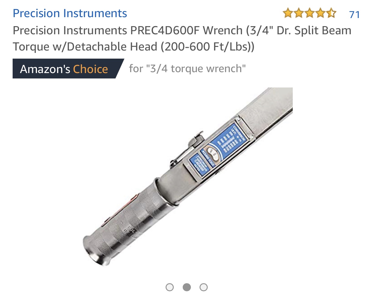

    I bought this torque wrench. I haven’t used it yet, but I think I won’t be disappointed. It came with a nice case. The product rating and pricing is higher than the average 3/4” torque wrenches.
    Reason for edit: Typo
    Dino soar Thanks this.
