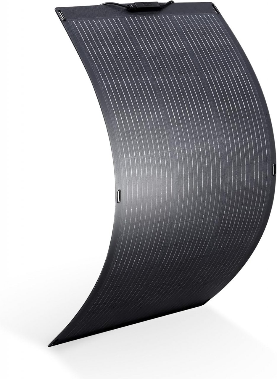

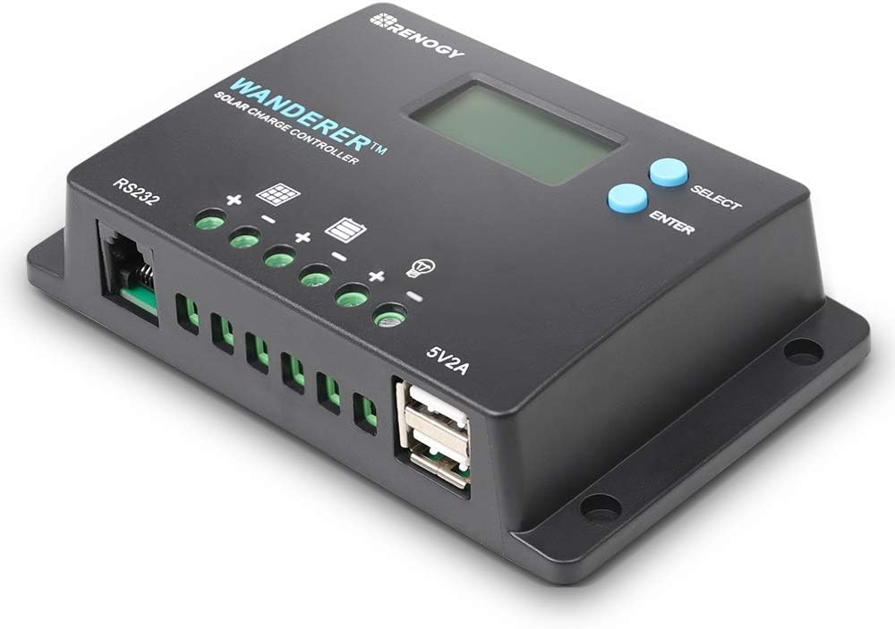

    Pretty much any 100-200W flexible pannel and charge controller will do it and then some. If you do it yourself its pretty cheap. If you want someone else to do it electric APU can hook you up pretty cheap. If you have an electric system tom at electric APU did the pannels.on my truck for my system and can do them custom to your rig so you idle way less when using the system.
    You can also get battery maintainers that are easy to remove if you dont need them often.

    Much information online about heat and installing flexible solar panels. Best install would have an air gap under the panel to keep it cool as possible. Not an option going down the road so the performance will suffer.
    Also, a 100 watt panel will not deliver 100 watts. Best mine does is just over 50 watts. It will keep the batteries topped but won't run much. It keeps the voltage up when parked on cold days and I'm running a diesel bunk heater. I've left the truck with the 12v fridge running for a few days but one cloudy day will cause the load shedding (international low voltage) to shut down the accessory circuits.
