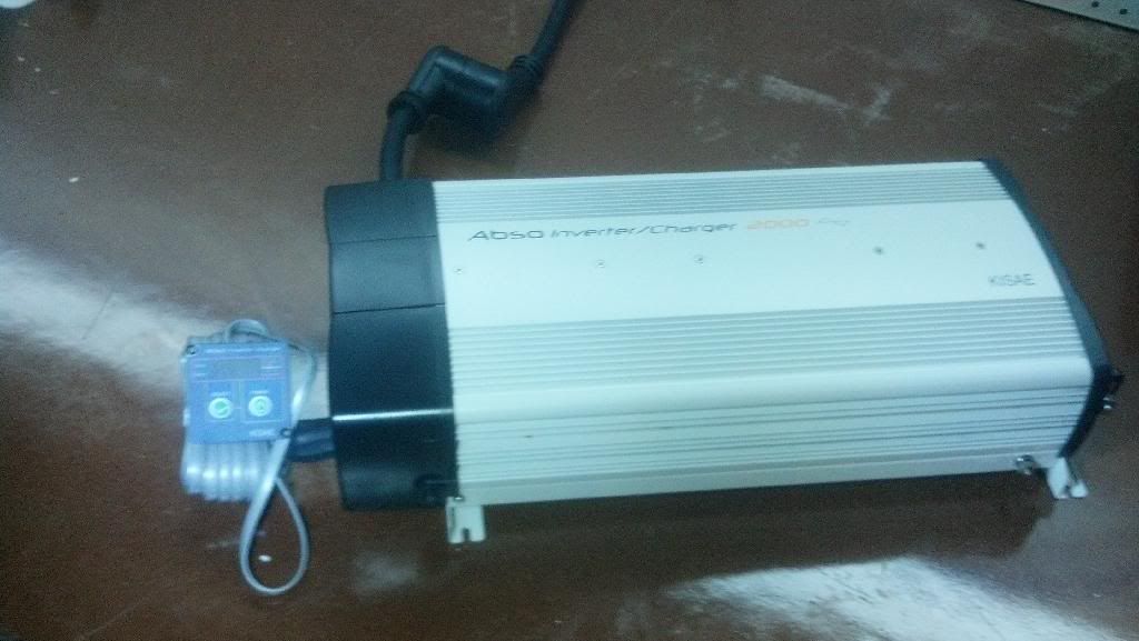

    I don't know where you are getting the $12,000 number you posted, but I would like for you to show where you came up with that number? I will not have a 1/3rd of that in mine including all new batteries, the Maxwell ESM, the solar panels, the AC unit and even swapping out a modified sine wave inverter for a brand new pure sine wave inverter/charger that I can hook up to shore power to run everything and charge the batteries. I also do most of my own work on it too that has been a fun and educational project for me.
    The new inverter/charger also has a control panel that I will also mount in the sleeper to monitor battery and inverter conditions.
