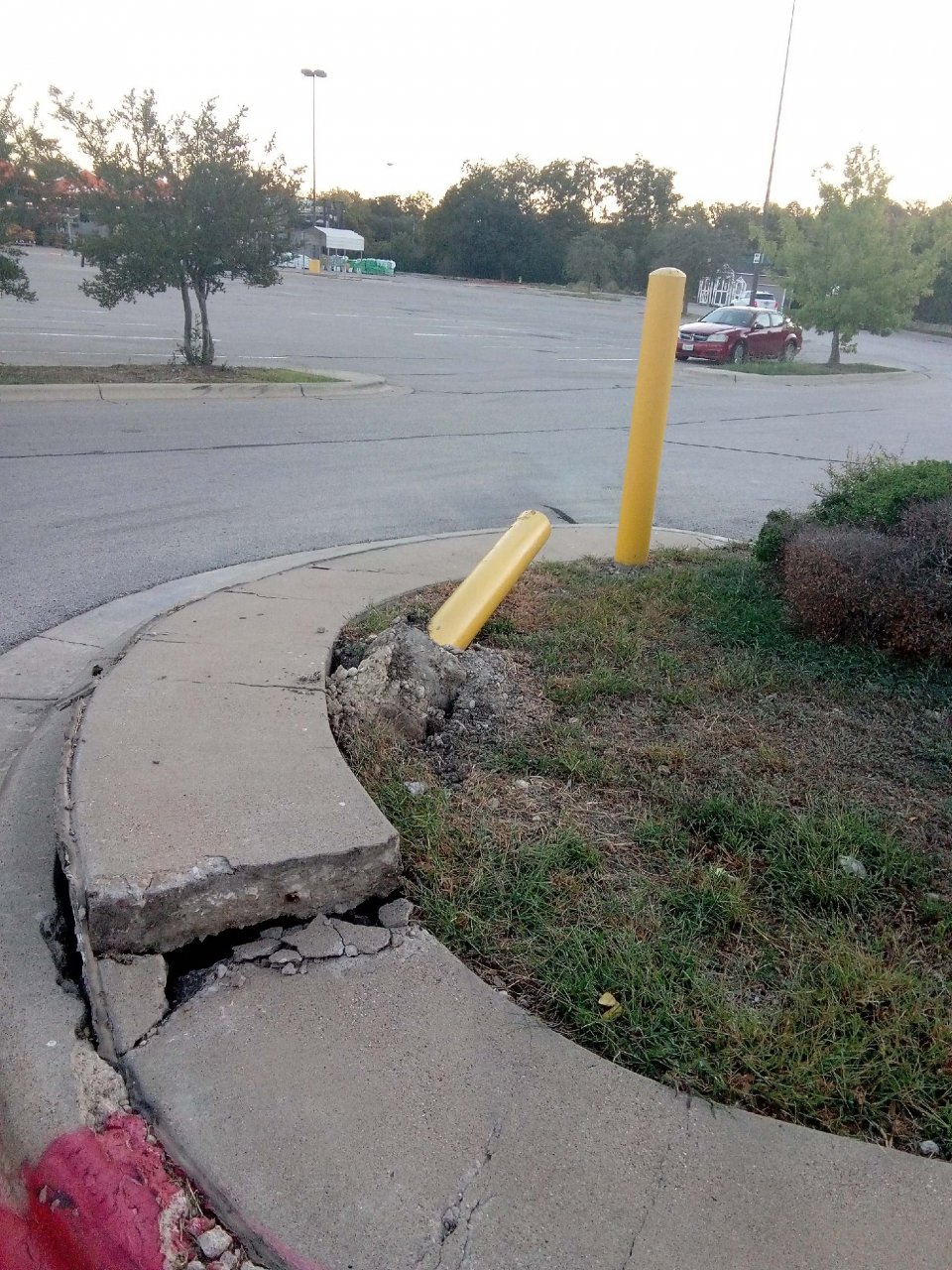

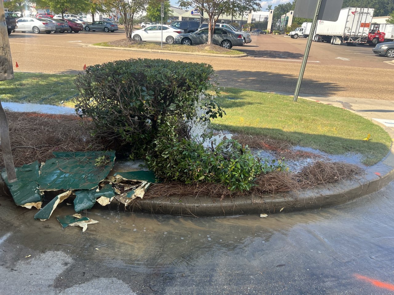

    Any thoughts on good design or retrofit solutions you've seen at tight corners, particularly entering and inside parking lots?
    I'm looking for solutions that respect a driver's need to get to the destination and the property owner's need to control traffic.
    As a property manager, I have some control over repairs and retrofits which could improve the situation.

    I've been looking at transversable curbs and truck aprons like on mini-roundabouts and some right turns.
    The hope would be that the transversable curb is high enough that the average car driver wants to avoid while small enough that low speed truck traffic rolls right over. Because it is built for the load, the truck apron protects from ruts and crushed sidewalks.

    installing irrigation back flow preventers right next to a tight turn curb is never a good idea

    The highway exit was relocated and funnels more trucks into the route in red. The old ramp moved more traffic behind the big boxes on the blue line. Either way, that hairpin in the red line is where the bollards were knocked over and is tight right and left.
