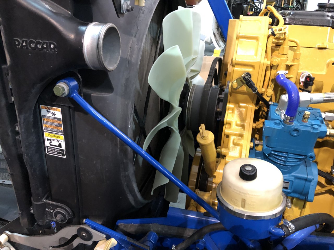

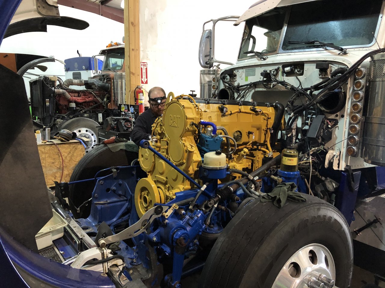

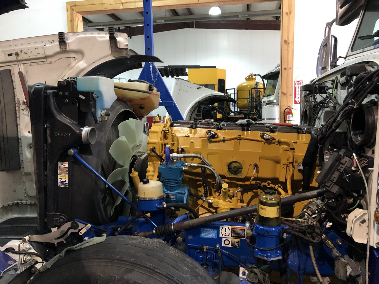

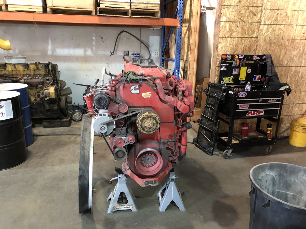

    I did a ELOG, EGR, DPF, SCR, red POS delete on my 2014 389 last year. Only has 80,000 and change on the clock so far. I’m hoping for one inframe before I retire after this. 55AFA59C-6463-46C6-95C6-2809B034851E.jpeg 31202587-06A8-4CCA-80F6-9D8DDD426FC2.jpeg 4492E01C-8307-4831-9541-036AC3DD4CDF.jpeg 1093079F-9549-473D-92F6-B17C924BD406.jpeg

    Where did you source your wiring harness?
  5. dirthaller
    dirthaller Road Train Member
    1,137
    13,630
    Sep 22, 2011
    Coloratah
    My mechanic used a schematic that he acquired for my truck, bought a 120 pin cat ECM plug and wired it up. He said that his brain was smoking a little for a day. He forgot to wire my ambient temperature gauge because the Cat engine doesn’t require that information ignoring the fact that I would still like to read ambient temperature on my dashboard. He says that he’ll fix it someday….it’s been almost a year now and he hasn’t gotten around to it yet.
