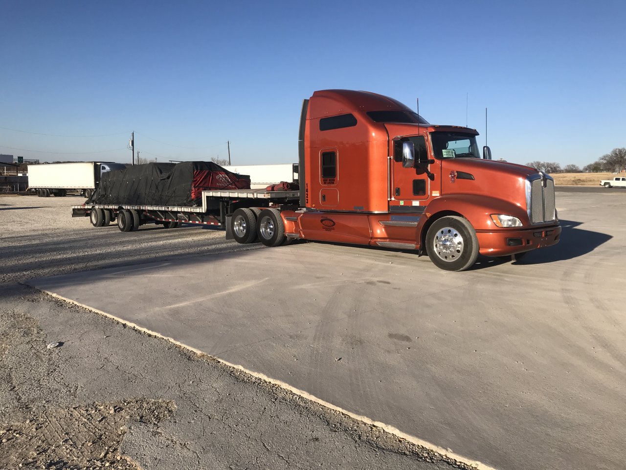

    I’m a new O/O and don’t like renting a trailer for $650 month. Thinking of buying a new flat bed trailer. My truck is a T660 Studio and it has all my wife’s stuff in it so it’s heavy.
    I’m welcome to use any available trailer in the fleet for the rental price. Been pulling a 22.5 step deck and not found any advantage to it. Some say I need a 17.5” low pro to be an advantage. As I search the load board I’m not finding many specialized loads for the trailer but lots of loads for a flat bed.
    I like the Fontaine Revolution but the edges are so slippery. Since my wife and I are getting up there (50) might be better to have a traditional sided trailer like the Reitnouer.
    Not sure the difference between the Big Bubba and the Maximizer but I definitely see a lot more Maximizers running around.
    I need to keep the weight down since my tractor is heavy. Is there any advantage to 53’ over the 48’?
    This is what I would like to have,
    Tool boxes
    Dunage rack
    Electric rear axle dump
    Extra pretty lights
    Please share your views on getting the appropriate trailer. Thanks.
