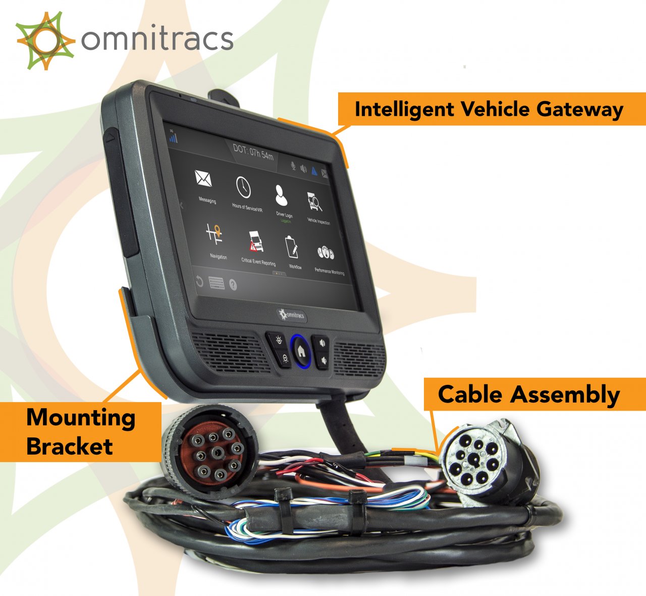

    I have an older unit. It never worked right. FEDEX gave me an exemption. Now I have to have it working.

    I have the Omnitracs as well and having this same issue. Company says it is showing speed sensor failure. I have it in a 97 Pete. This is second eld unit and different brand. Another friend of mine is experiencing the same issue on his 01 Pete. I have to go to a service center and pay someone to figure out why my “plug and play” isn’t fully playing.
    You mentioned your truck was Canadian. Mine is also a “Canadian “ class Pete. If that makes a difference I would like to know
