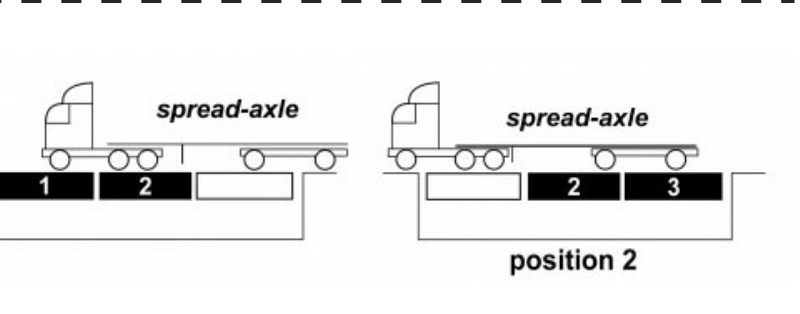

  1. Yes. Say. First weigh. Spread axle
    Weigh me on pads 1 and 2
    Then I'll move to second position
    Pads 2 and 3

    Cool. Usually I just weigh like a tandem trailer. If I'm close to 40k on the spreads I would drive on backwards and reweigh. The 2 position would be much simpler.
