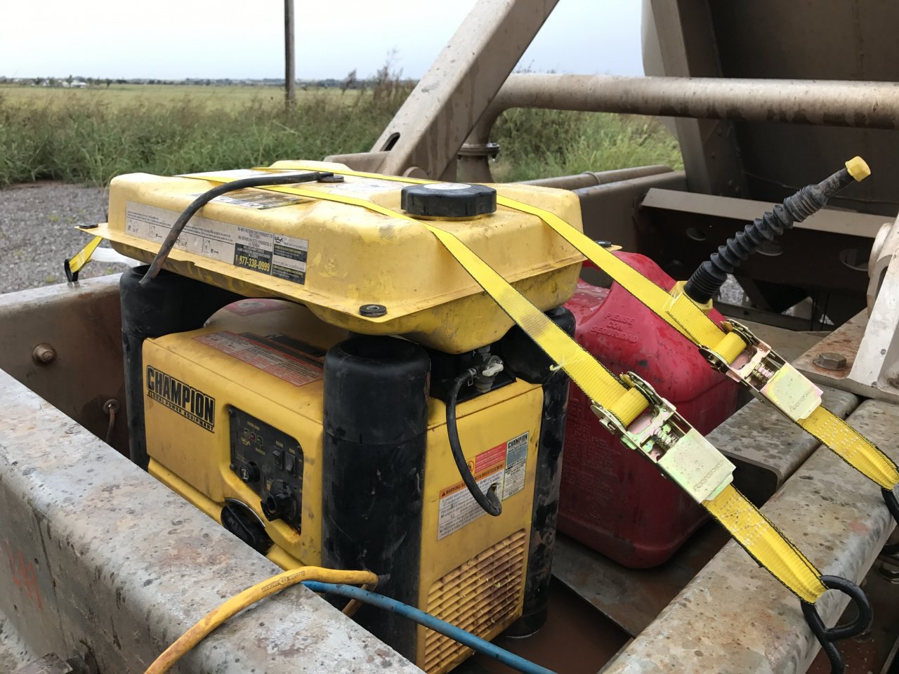

  6. ShooterK2
    ShooterK2 Road Train Member
    5,533
    89,470
    Dec 14, 2012
    Oklahoma
    You can use just about anything. I robbed a tank off an old generator and ran a fuel hose straight to the carburetor. Make sure the petcock is closed while driving and you’re good to go.
    I’ve since upgraded to the 3100 Champion. The 2000 had a hard time starting the compressor on the really hot days.
