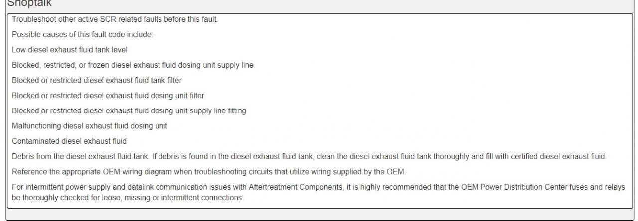

    What kind of temperatures have you been running in? Are you using a winter front?
    Found this on justanswer.
