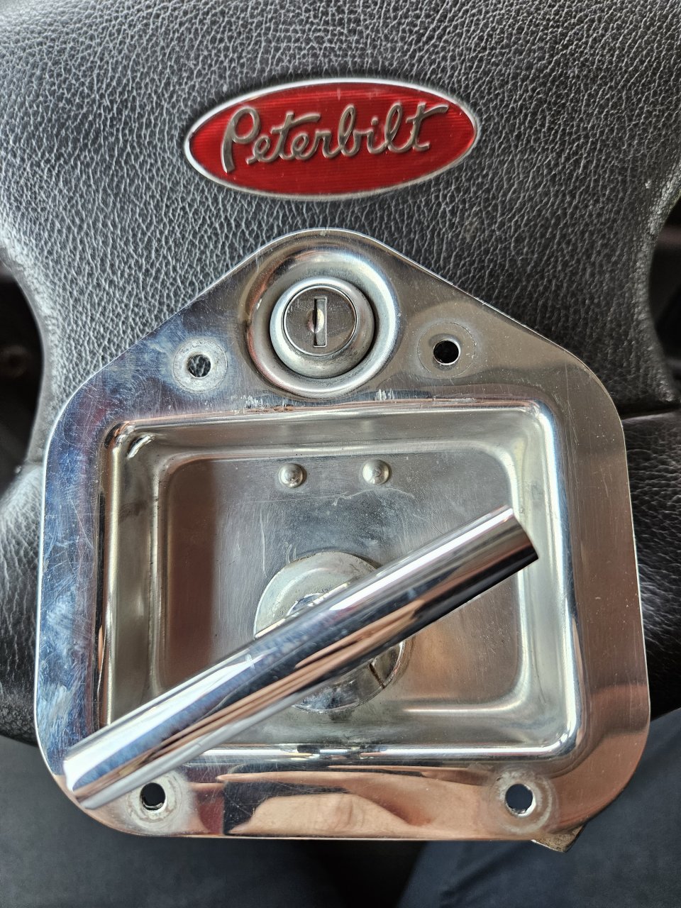

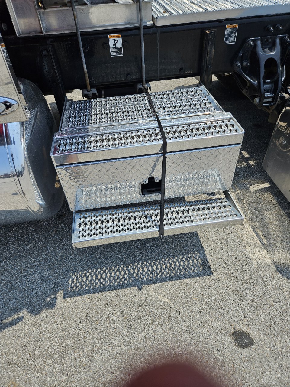

    Just tried to purchase a new lock latch " peterbilt" specific and they wanting a whopping $450 for this latch...
    Rolling with the bungie on my box is driving my nuts...

    What the hell man. That should be a $50 part at most. Seems I would be replacing that lock with something else. Would never give 450 for a lock. They are on crack to say the least and I would tell them how I felt about it as well. Ha ha

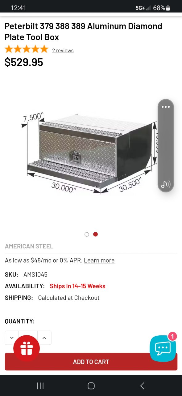

    Ya they claim $1600 for a new box, did some Google searching and came up with this, so gonna call them tomorrow. Seems a no brainer provided this price is current...

    Yess they have lost it. Looks like link above mine might work.
