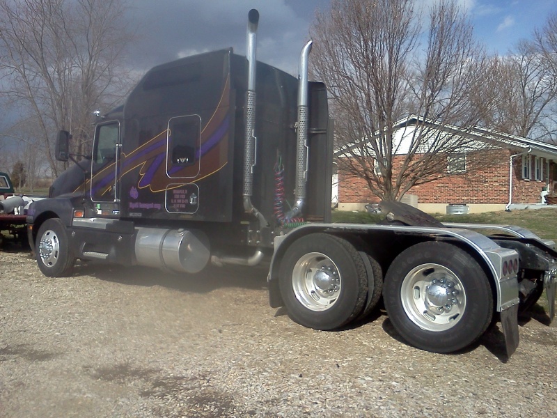

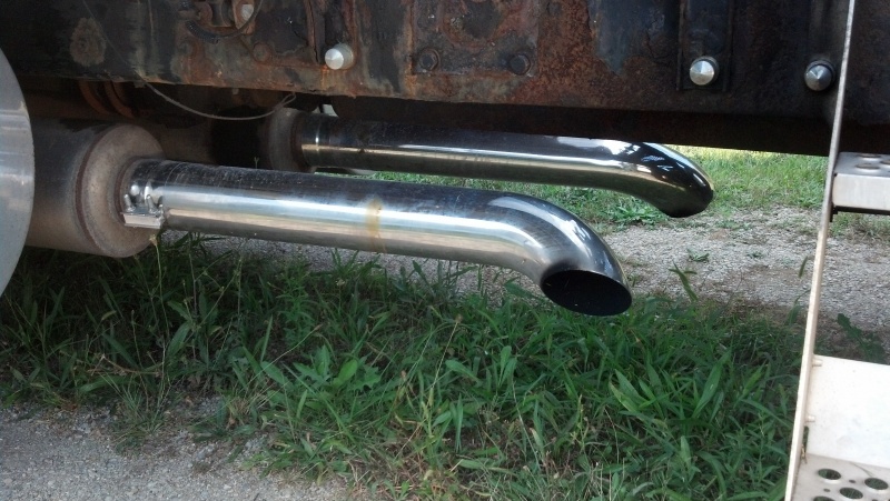

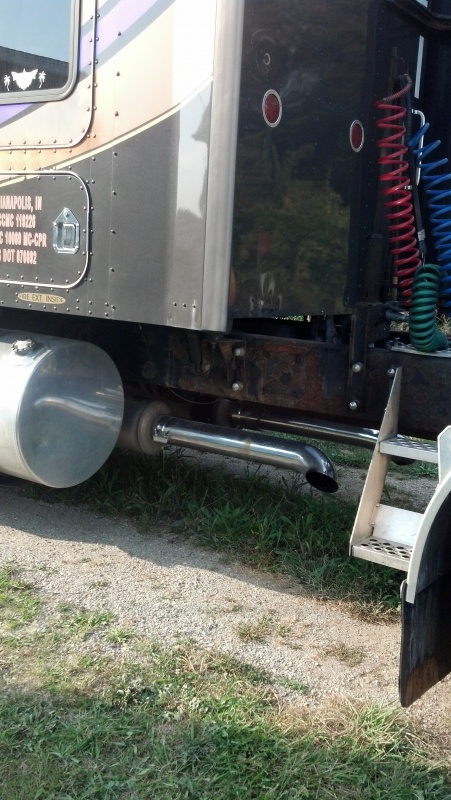

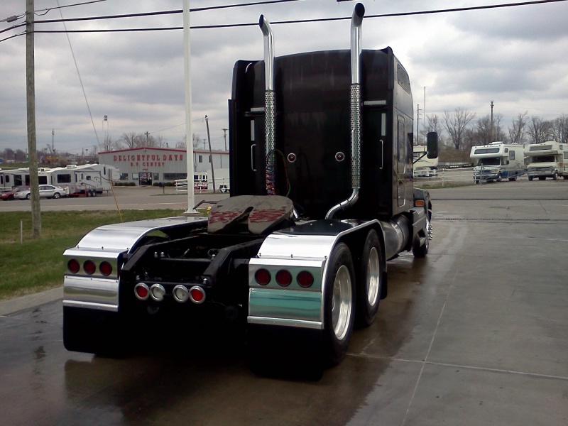

    Between the cab bracket and the pipe bracket. Not gonna work on the KW. After 4 sets of the crap they are pushing now,(KW) and 2 sets of pipe brackets and stainless pins this is what I have come up with so far. I'm thinking about putting 2 new pipes on the mufflers that are 12-18" longer and leaving it that way.
    used to look like this...
