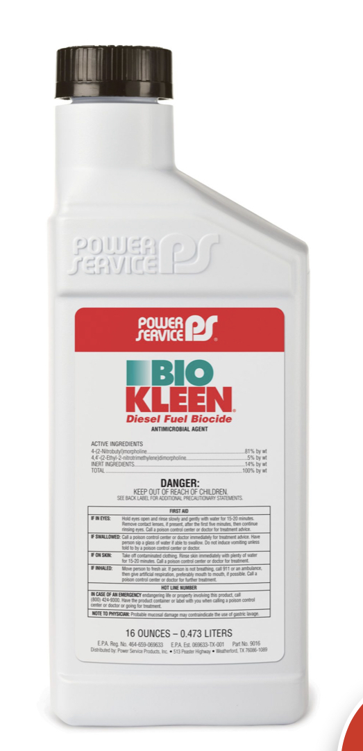

    Cummins recommended. Can be bought at Auto zone and O’rielly’s. Around $30. 16oz. Will do 50-100 gallons. Dose depends on severity. Once that algae or asphalt gets a hold of the tank walls you have to add it to every fill up until tanks are clear.
