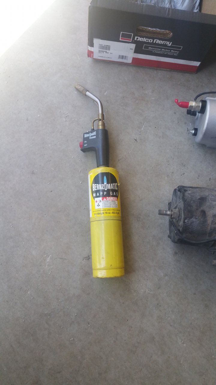

    Here is what I used to heat the bolts up. Welding the one wasn't enough to unsieze it. Still had to heat it up to break it loose. My finger felt like it was going to fall off after holding the trigger for about 10 minutes x3. But it had the desired effect.
    20170318_135411.jpg And amazingly enough I could see a slight red glow to the bolts after a while. They broke loose easy peezy with a small breaker bar. I was skeptical this would work getting enough heat in there but if you're patient and heat soak it for about 8 or 10 minutes it works. For guys who don't have acetylene torch looking for a cheap alternative.

    Did you put never seize on the bolts going back in? Hopefully you don't have to change starter ever again but if you do the bolts should come out easier.

    @rollin coal , you know, you are right. That map gas actually gets pretty dam hot. I keep one exactly like what you have in my side box for winter time emegency and something is froze up. Works like a charm is your careful.
    Im glad you got that one out and it didnt gall up the threads in the aluminum flywheel housing! I bet your feeling better about the starter situation now.

    For sure glad it came out. Yeah I put plenty of copper anti-seize on the threads. Should come apart easy the next time. Sounds like a Volvo cranking :-/ guess they put these high torque starters on those from the factory.
