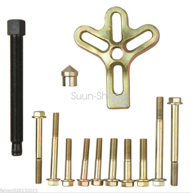

    what tool did you use to pull that yoke? would I be able to pull it w a regular puller or do I need one of these heavy duty like tiger makes?
    x1Heavy Thanks this.
  11. Justrucking2
    Justrucking2 Road Train Member
    3,211
    4,295
    Sep 12, 2017
    Plymouth MI
    I had my ProStar lose the carrier bearing on the road, which was a good thing, as we wound up putting all new u-joints in the driveline. When it came time for the yoke, the shop had to send it out to a machine shop to remove it. If the truck has been sitting, I see a machine shop in your future.
