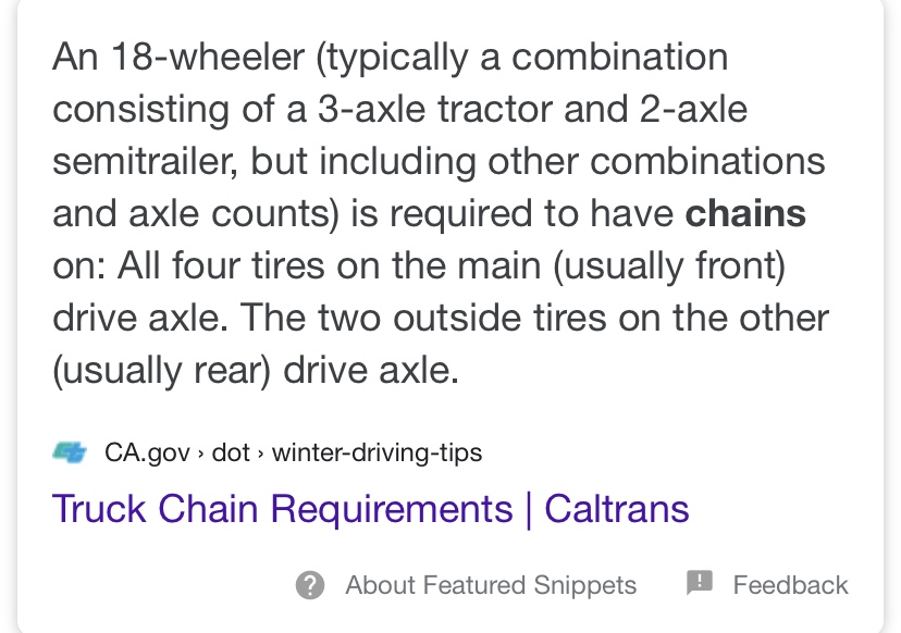

    I have looked online for guidance and I used the search bar to try and find it here. Can you guys show me where to find the regulation/guidance that tells you what the chain laws are for each state? Is there a website that shows them all?
    Thank you for your time

    I want to clarify that i am most curious about how many chains i need to put on the drives per each state. I have read i only need 1 per each dual and 1 pair on a trailer in Washington. Is that the highest amount of chains required?

    Max chains in Cali is 6 drive tires chained.

    Sometimes CA can require all tires on the front drive axle be chained in addition to the previous requirements for the other axles. But from what I've seen, usually if conditions are that bad, they close the road instead.
    WA also requires you to carry 2 spare chains in the event that your chains break or fall off.
    https://dot.ca.gov/-/media/dot-media/documents/chainrequire-a11y.pdf
    https://wsdot.wa.gov/sites/default/files/2007/05/16/CommercialVehicle-ChainRequirements.pdf
    Minimum Chain Requirements in Oregon | TripCheck - Oregon Traveler Information.
    https://www.codot.gov/business/permits/truckpermits/documents-1/csp-tire-chain-requirements
    WY requires only 2 total chains, on opposite ends of the same drive axle.
    UT requires 1 chain on every wheel end of every drive axle.
    ID is 1 tire on each side of any drive axle, and 1 tire on each side of any trailer axle.
    MT requires all tires of one drive axle.
