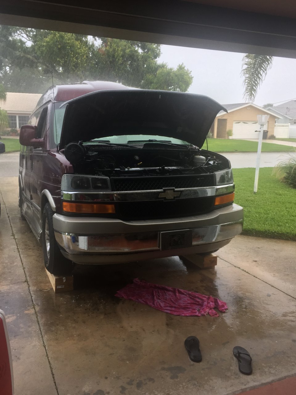

    I was just chasing a squeaking sound I was hearing at start up thinking a new ac and serpentine belt would fix it since I did not replace them when I did the idler pulleys 6 months ago because the parts place didn’t have them and they looked new yet.
    Ran it up on my homemade wramps at my buddies house in st Pete in a nice deed restricted neighborhood thinking I would be done in an hour .
    His Wife is a doctor and doesn’t understand the intricacies of mechanical repairs.
    And is Not humored by a vehicle up on jack stands in front of her waterfront home
    Removed all the belts and rechecked all the idler pulleys and by chance rolled over the alternator and heard a slight squeak.
    No problem easy fix. Napa has a new one in stock.
    As I am wrenching off the alternator I notice the bracket kind of moving.
    I just bought this Super clean one owner 2003 van last year with 90 thousand on it.
    This is my first real time tearing into it other than doing the idlers and replacing the front wheel bearings.
    I’m like Well. I can’t live with this Worry in the back of my head.
    Tear down the drivers side of the motor.
    It’s 96 in the sun and now it starts pouring rain and I am working in it thinking here is a respite from the Heat.
    My first time working on a LS motor so not familiar with it and all vans Suk to work on the front side of the motor
    Get the bracket off than time to remove broken bolts.
    They are not moving.
    So off to buy a torch and some Map gas and PBB blaster.
    Heat doesn’t move them on this rust free Michigan van.
    Soak them in blaster and let them soak over night.
    Next morning I am Twice as Beat as I was the day before after a long weekend boating and Sand Barring 60 miles away by boat in Dunedin
    By the way I saw over 500 Trump flags and Clearwater is having a World record recordable Trump boat parade this weekend.
    Day 2 I am beat and wake up early to 98% humidity but only 85 degree heat at 7 am.
    Whoo Hooo
    I wrestle with the bolts till noon before I break them loose and than go find some replacements
    Now time to reassemble. Drive out the old alternator bracket bolt bushings and look in the box and the new ones are missing
    Off to Napa to find them.
    Get it all together and now the Joy of trying to Route the serpentine belt through its twisted journey all by feel because with this stupid van you can’t see #### in the engine compartment.
    I almost missed working down in the bilge of boats because there no one could hear me Weeping and Slowly Losing my mind and proclaiming I will Kill the first GM engineer I meet.
    I am Soo Sore from Heat Exhaustion and crawling up over and under that van a 100 times.

    I watched a video of Make Cents on youtube where he used a plug welding technique to remove broken exhaust manifold bolts on his K900 with an ISX, IIRC.
    I don’t remember the exact thing he did, but it was way easier than using an extractor thingy.
    tommymonza Thanks this.
  6. tommymonza
    tommymonza Road Train Member
    4,519
    12,851
    Sep 10, 2013
    S.W. Florida
    Yea if it’s flush I would weld a nut on it and get on it. I had bolt meat left after removing bracket.
    I’m guessing bolts were not threaded all the way and got ran in at factory.
    Dealership probably worked on it for rattle and twisted off the bolts and left it.
