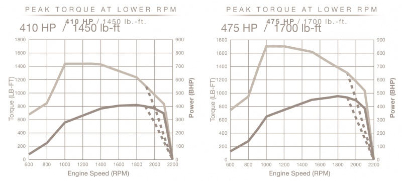

    On the chart looks like max torque and max power at 2000rpms then it flattens out...so im in good shape in 9th gear @ 1800 cruising 55-60 then as long as i dont let it go over 2000rpms? Sorry guys I'm so new at this and I'm always heavy.

  11. double yellow
    double yellow Road Train Member
    5,946
    10,066
    Aug 28, 2011
    State of Jefferson
    He is in a prostar so I assume he has the Maxxforce 13. It is a low rpm engine that pulls well down to 1000rpm:
    There isn't much reason to go over 1400rpm other than to hot rod -- to cruise at 1800 is just wasting fuel wearing out the engine faster.
