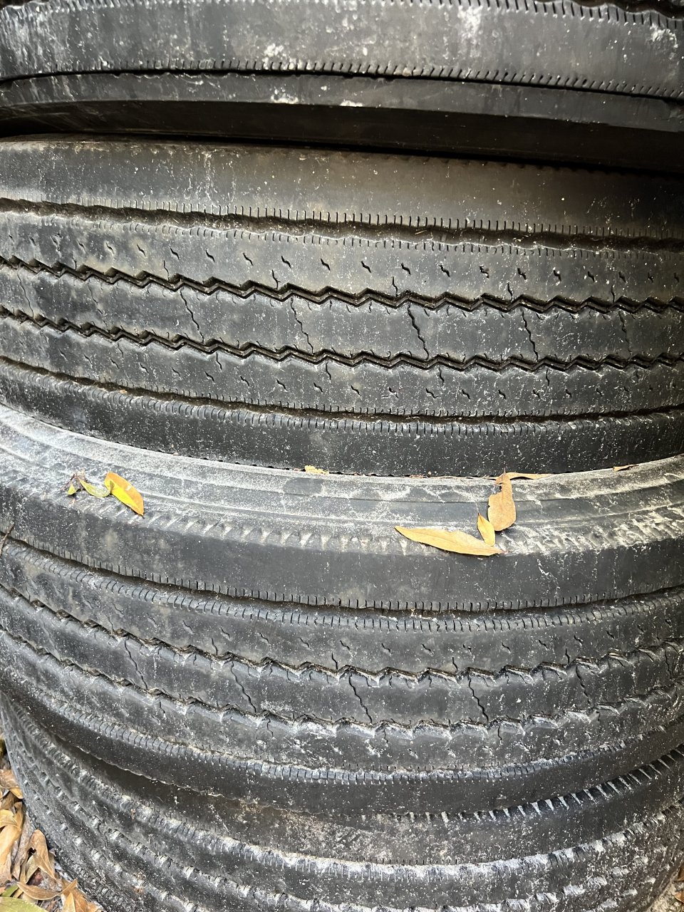

    Ok so figure out alignment issue first. Then when tread is to 4/32nd replace tires and shocks with a fresh alignment?

    There is a date code stamped into the sidewall of every tire.

    If you don't know the mileage I would replace those, at least soon. You can get the date code as Joey said and check the age but those are looking a bit rougher than I would like.
    I'm a Michelin only guy after running some other steers. Never tried Yokos.
