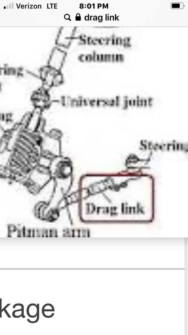

  8. Rideandrepair
    17,572
    56,924
    Aug 8, 2015
    EB2EC273-9F1A-42A2-89C1-78668D8BC186.png That’s what I meant, adjustable drag link, not pitman arm. My bad. Here’s a pic of what we’re talking about.

  10. Hulld
    Hulld Road Train Member
    2,884
    6,568
    Oct 19, 2015
    Upstate NY
    What you are referring to is the cross link from one side of the truck to the other and is NOT the drag link.
    The drag link is the short link from the Pittman arm to the steering knuckle as stated previously by others.
    Unfortunately most modern trucks don’t have adjustable drag links any longer.
    On my 2007 Columbia ( same steering column as a century I believe) you can pull the steering wheel and adjust it.
    Also even though the steering shaft at the steering box is sloted you usually can move it one tooth in either direction from center and still get the bolt in.
    Dino soar, Rideandrepair and AModelCat Thank this.
