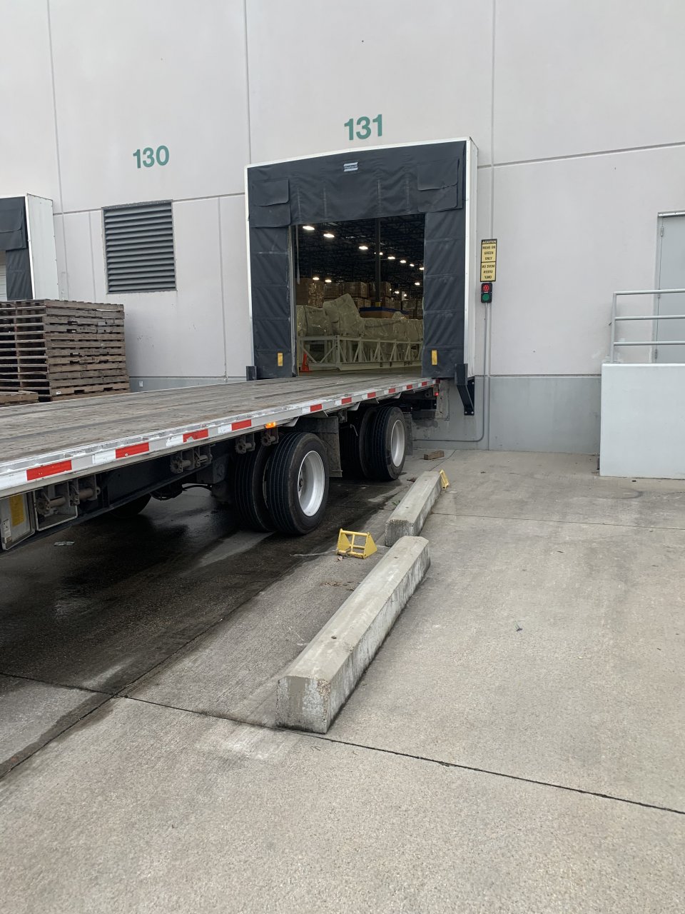

    Have you tried to load a step at a dock before? I’m sure there are taller docks but I can get level with most floors by using the overinflation system.
    Before 273CE9FD-9173-43BA-A38A-393BA2A0AA17.jpeg Overinflated 8D2D74BE-5786-42BF-B1B3-7D86DEC5DDD3.jpeg
    Honestly both heights would work for most loads.

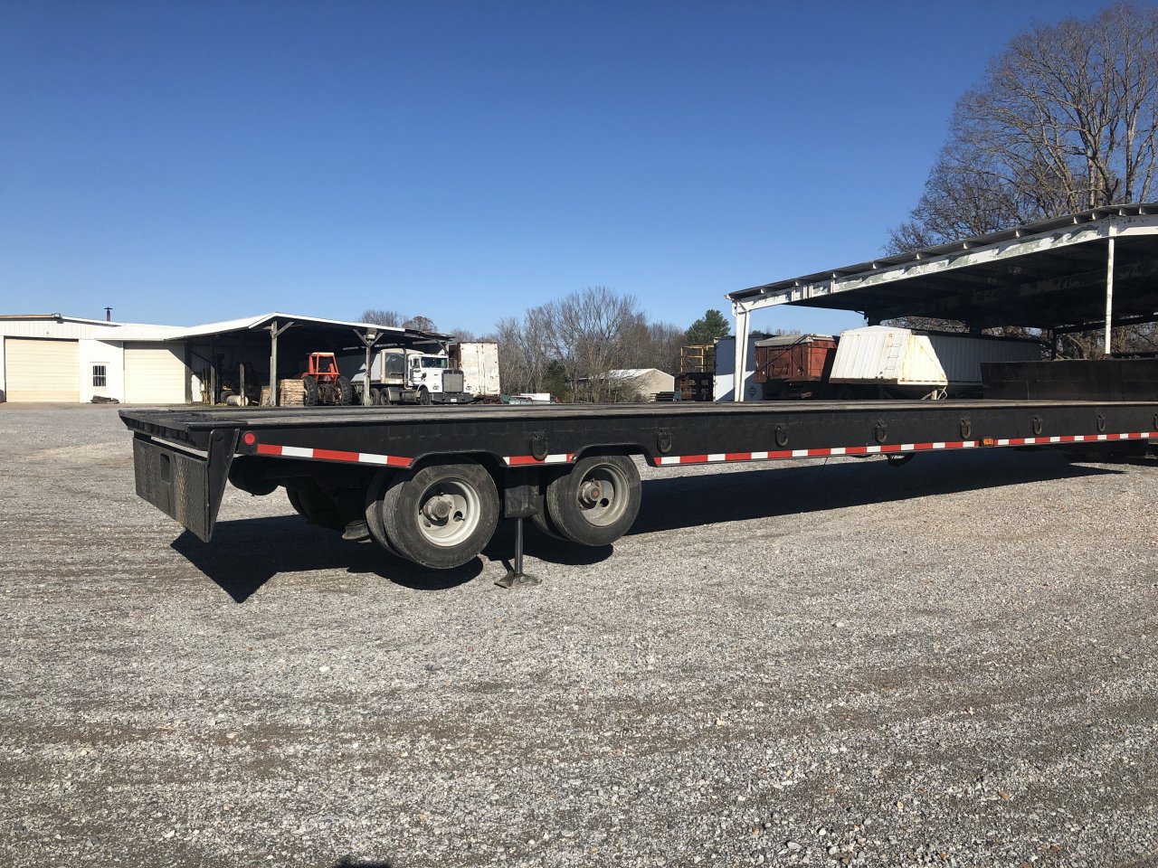

    I’ve only heard them called dock levelers. Here is a picture I took of a trailer we were selling that shows the levelers.
    One thing is that most of these traveling axle trailers are already setup and have the brackets to accept the jacks. I’ve never seen a standard step deck setup to accept them, so it would likely require some fab work to get them mounted. Another issue is how you are going to power them. These traveling axle trailers already have hydraulics, so you just tap into the existing system. I would say an electric 12v pump would work. They are also kind of expensive. I bought a set to retrofit a Landoll, and I think the price was around $6,000, and this was a trailer that already was already setup to accept them, I would say the price could go well over $10k if you have to make the mounts and hire somebody to do it. One last thing is weight, I think the set I ordered shipped at around 1,500lbs, and that’s not including something to power them. I say all this to say that unless you are needing to get to a dock fairly often, it’s probably not worth it.
