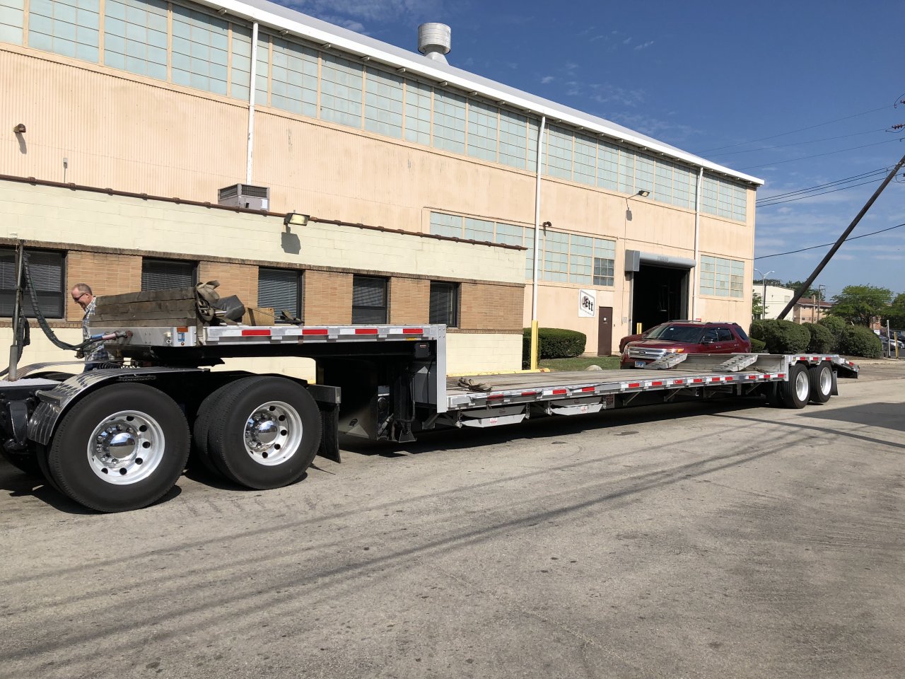

  10. Tug Toy
    Tug Toy Road Train Member
    7,099
    74,264
    Jul 4, 2015
    Corn field
    I fell in love with this beauty this week. Double drop with a beaver tail. D1A3C998-5587-433E-9B64-27C338A5CA7B.jpeg
  11. singlescrewshaker
    4,902
    42,976
    Dec 31, 2017
    Little Havana, FL
    Nice! Looks like it might have a rear lift axle on there also..
