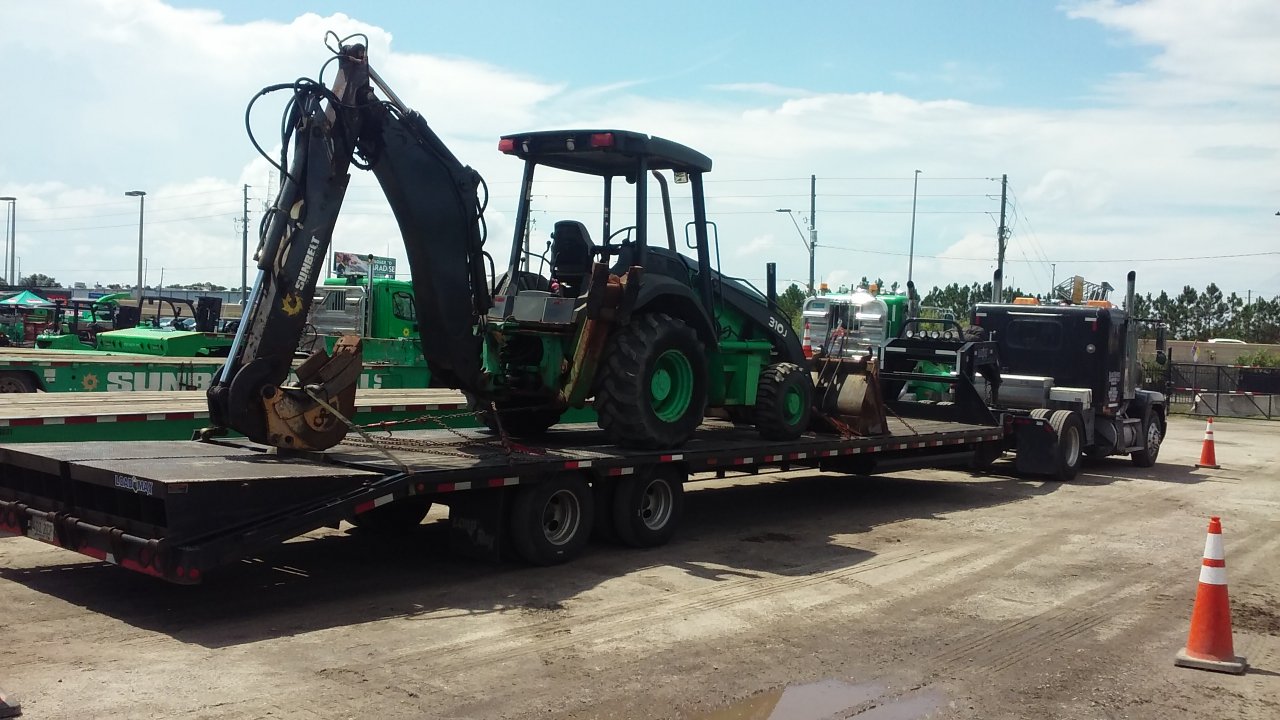

    I'm glad I started this thread. I learned a lot about step decks.
    Are there any issues with having a double drop like that?
    That's a nice trailer. Looks like it has a lower center of gravity more like a low bed but you still have the whole trailer length to load.

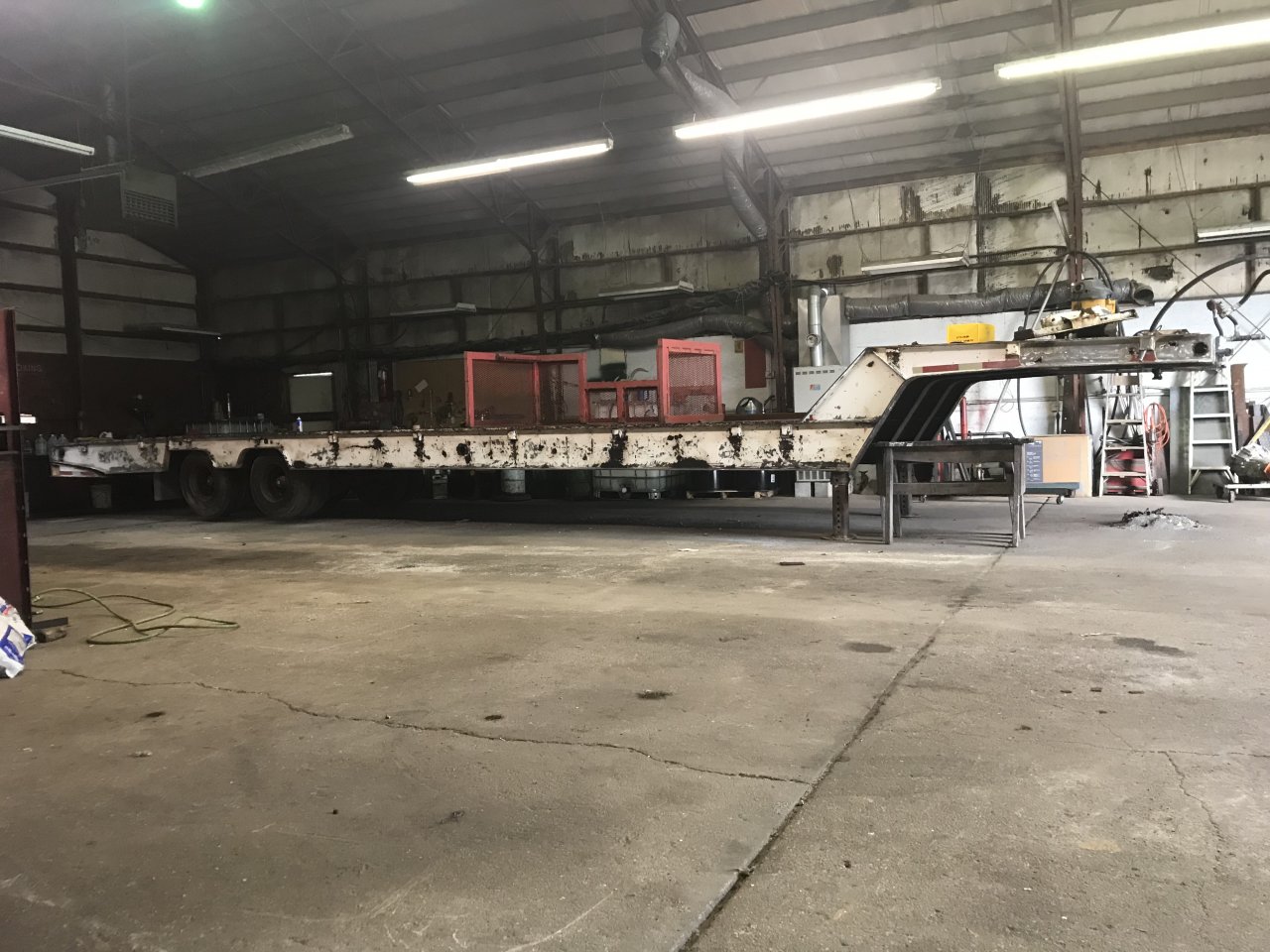

    AD332FAE-7C51-466F-9200-BEED45EF3A0B.jpeg I grab an new pic, but she got herself a crap ton of new metal. It’s amazing how much rot we found once we started pull the rust away. Very glad it was torn down before used. It would have been bad
    Like @rcelmo said, they’re a jack of all master of non. For our purposes it will work really well. But will still leave us with some limitations. A full on tilt deck would have better for us but i couldn’t find one this cheap. This guy will suite our needs well enough

    Excellent trailer for hauling forklifts, skidloaders, etc. I don't care
    for the Landoll full bed tilt trailer because some of the older forklifts the
    parking brake doesn't hold. I am usually by myself so I have to drive the
    machine on and than try to quick chain it before it rolls off again...…...
    With this style the main deck stays level while loading. The new Landoll's
    have remote control so driver can stay on the machine while operating
    the trailer....
