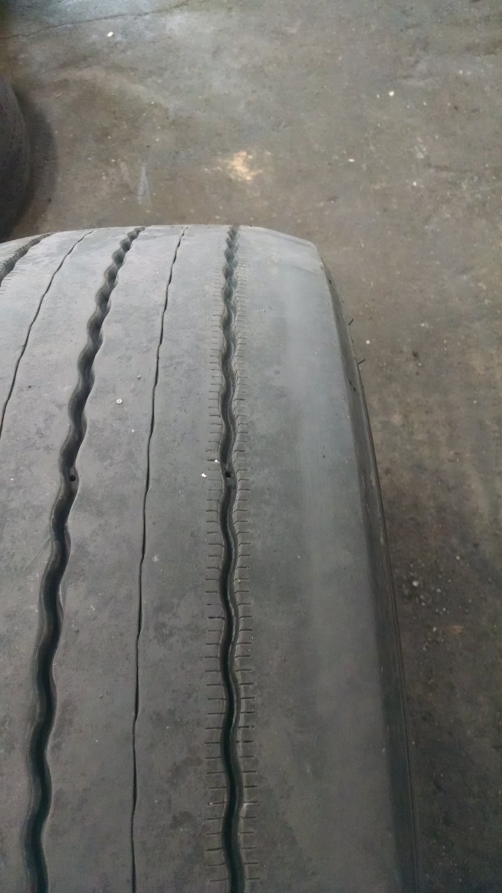

    Is this the kind of edge wear y'all were getting? IMG_20190507_152035062.jpg this was a fairly new set of steers we replaced for a different reason but that edge wear was bothering me. The set they replaced with these were not wearing like that same brand Michelin. They just put Conti's on here. I guess we'll see how they do if I don't get a new truck soon.

    Yeah that was a problem with the michelins. The continentals wear around wear the sidewall and tread meet up . The older style contis had a more square profile from sidewall to tread. The newer ones taper in just a tad. And it wears there
