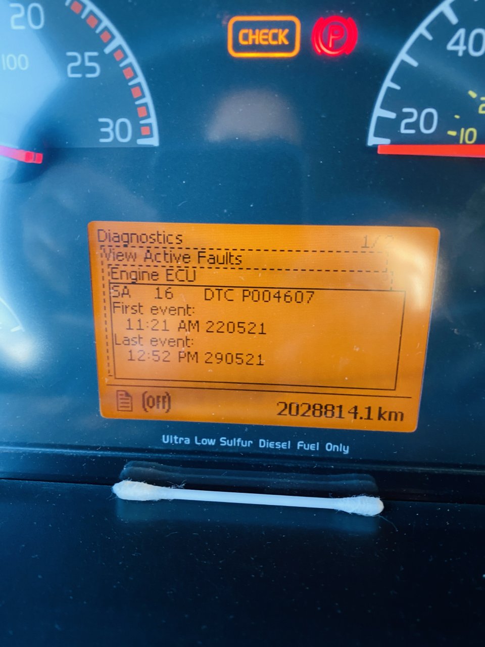

    Sa 16 DTC p004607 anyone knows

    5DDC1FBC-E3FA-4EB7-AF9A-B6A78461673B.jpeg What is this code
    SA16 DTC p004607anyone know

    Possibly VGT function for the turbo. It means the vgt isnèt working. you need to have dealership run a test on the turbo actuator. sucks but hopefully it is the actuator and not the turbo.
