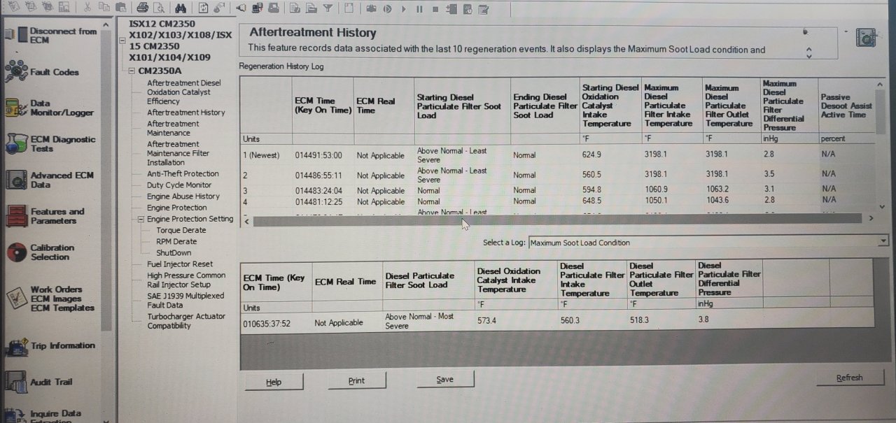

    I've had this happen before. The aftertreatment is at level 5 and thinks it needs the dpf replaced. It does not. I looked into it and had insite and all. Removed the dpf & doc, had them baked. They said it was pretty low pressure to begin with and probably didn't need it. Did it aby way. Had to reset the dpf through insite and fixed the light. Then did regen and no more issue. I have a sensor going bad and it thinks it's clogged. I looked at the last 10 regens and they're right at 3.3hrs key on time between them.
    No point in letting it sit at a dealer waiting on backordered parts if I can reset, regen and keep going for another few hours.

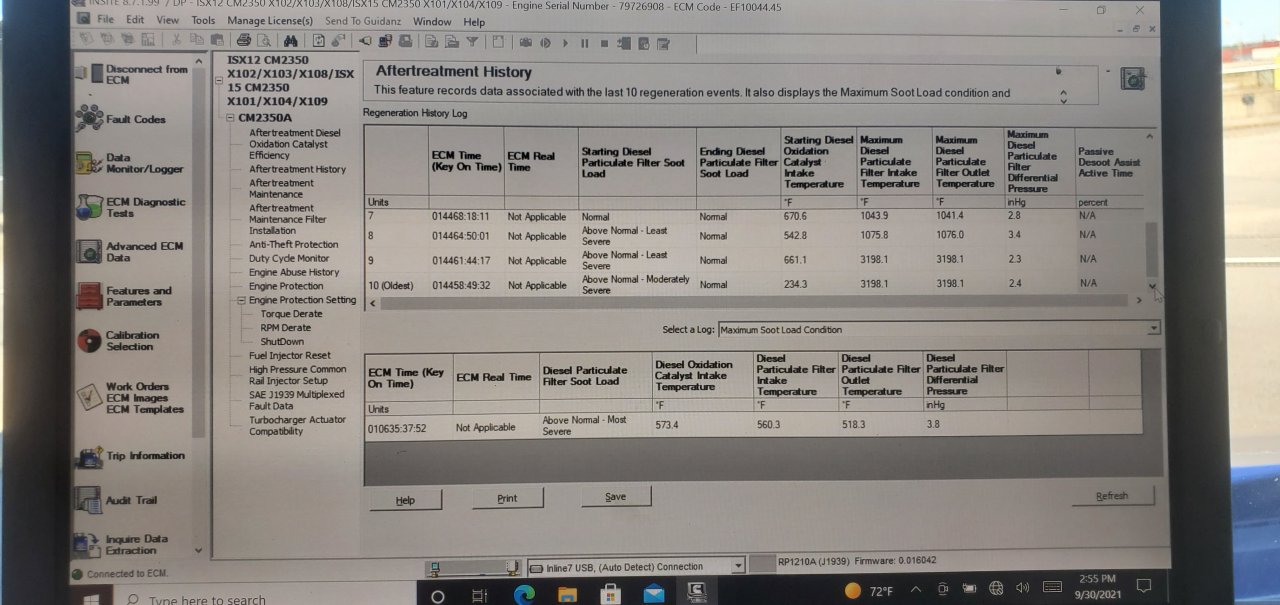

    These are the last 10 regens

    3000* F DPF outlet temps????
    Regens are way too close together. But may be because of fault codes. The high temp reading, which is not rational is likely your SEL

    Darn near triple what they should be.
