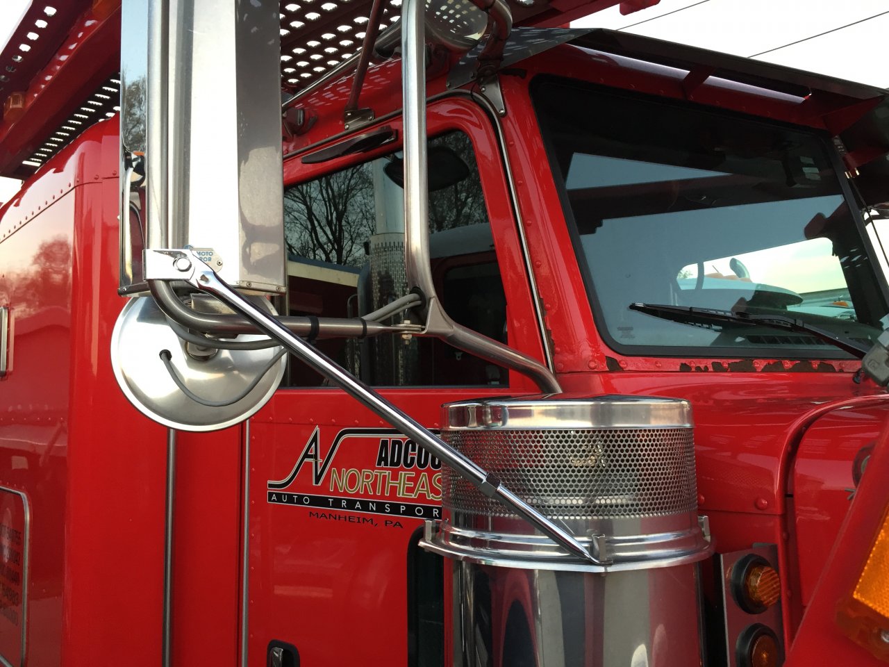

    image.jpeg image.jpeg image.jpeg Just thought I would share this little tip with you guys the mirrors that shake on the Peterbilt's drive me crazy I found a solution very easy cheap and anyone can do this look at the pictures thanks guys

    I like it but if you do that on a pre -05 model you can't open the door. :(

    I agree. Usually, "mirror shake" is a symptom of a more serious issue. While the truck doesn't look too old, I'd rule out a bearing or driveshaft, but 1 curb hit (or mega pothole) on a steer tire is all it takes to ruin a tire. ( or trailer problems) Most Pete's (and KW's) I've driven, you could see out the mirrors just fine. Now that IH 4070B, THAT had mirror shake ( along with the rest of the truck:biggrin_2559:)

    Yeah but I just loosened the bolts and now the mirror hinges closed when I open the door and hinges open when I close the door.
