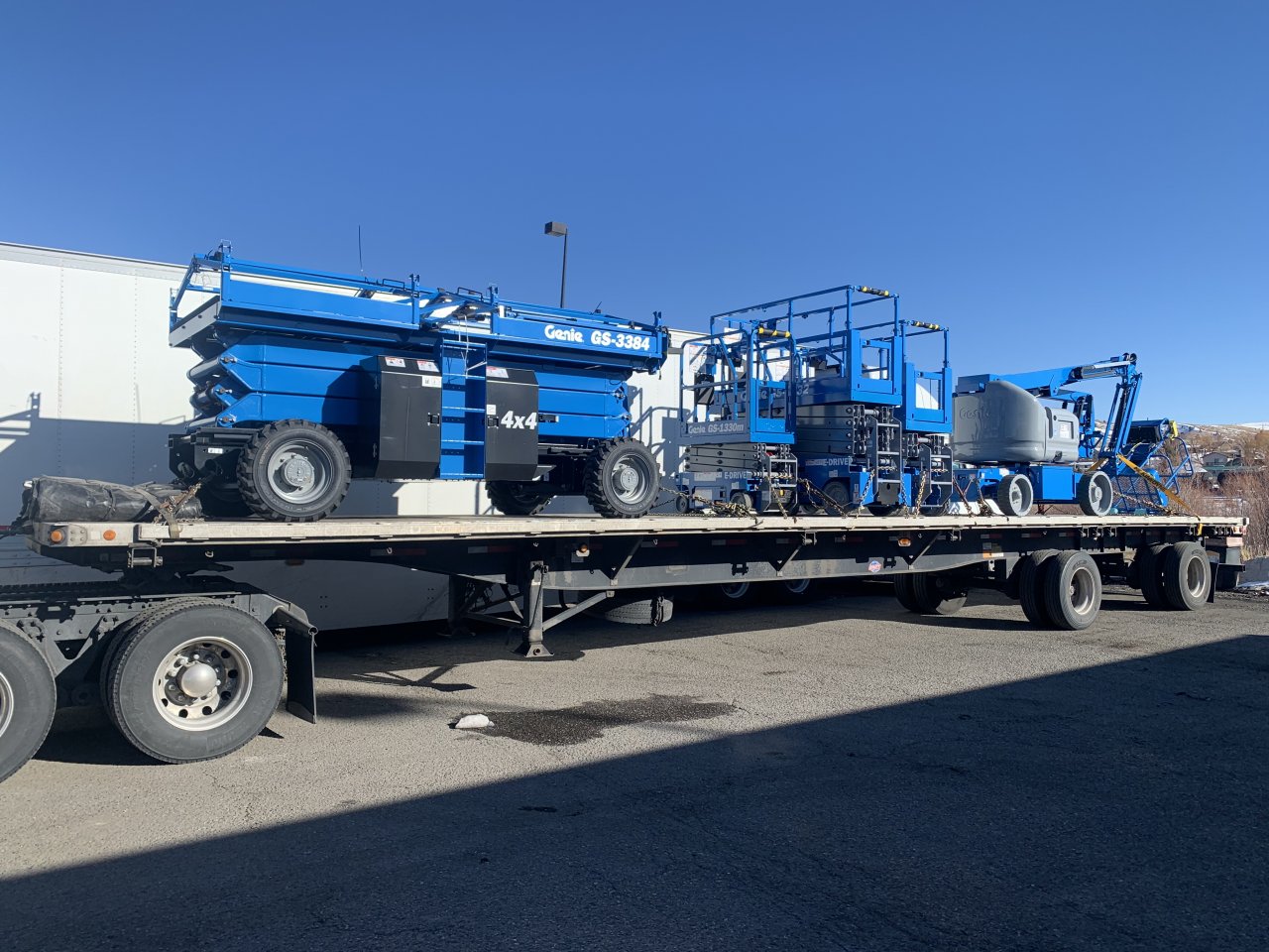

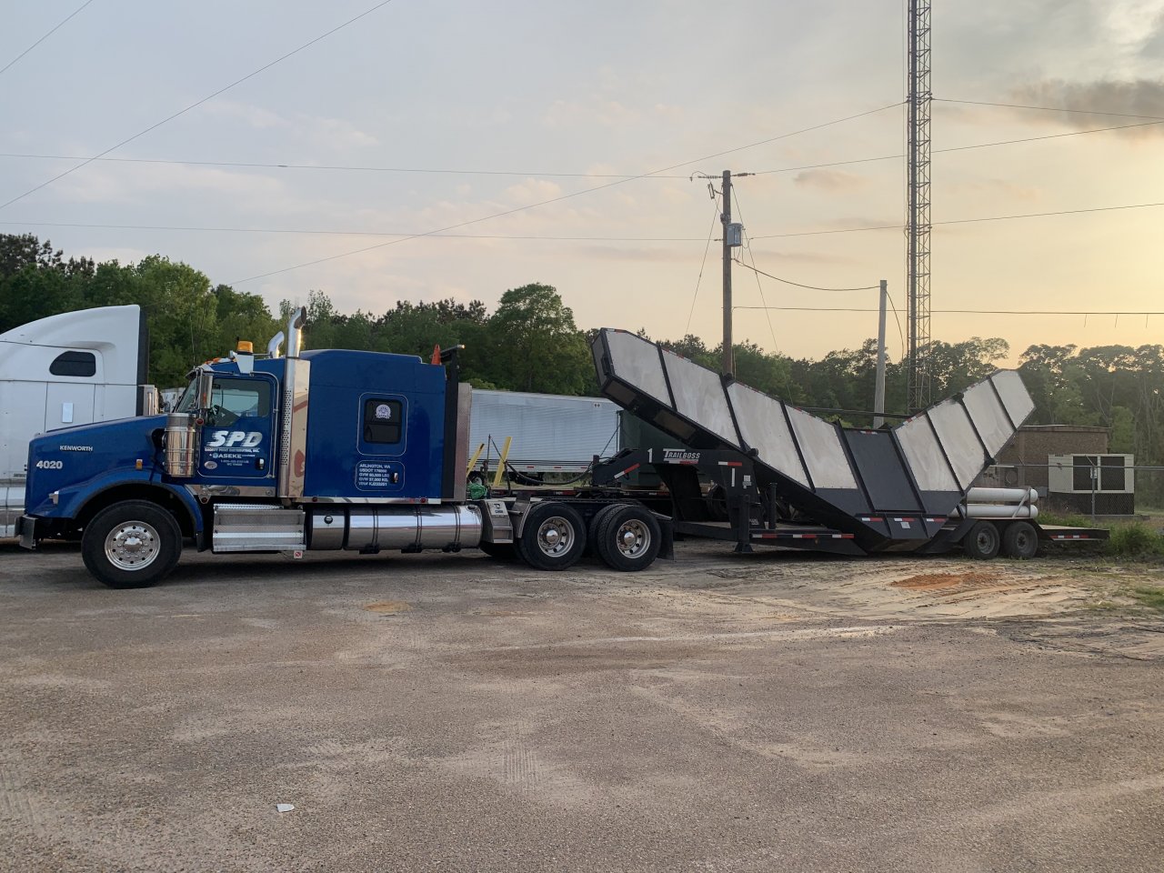

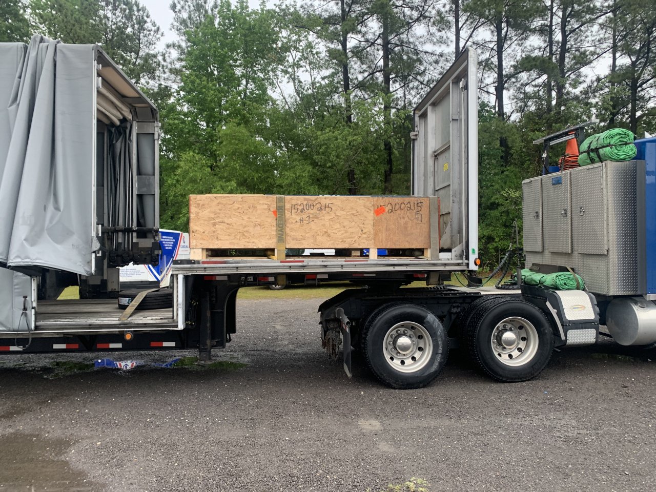

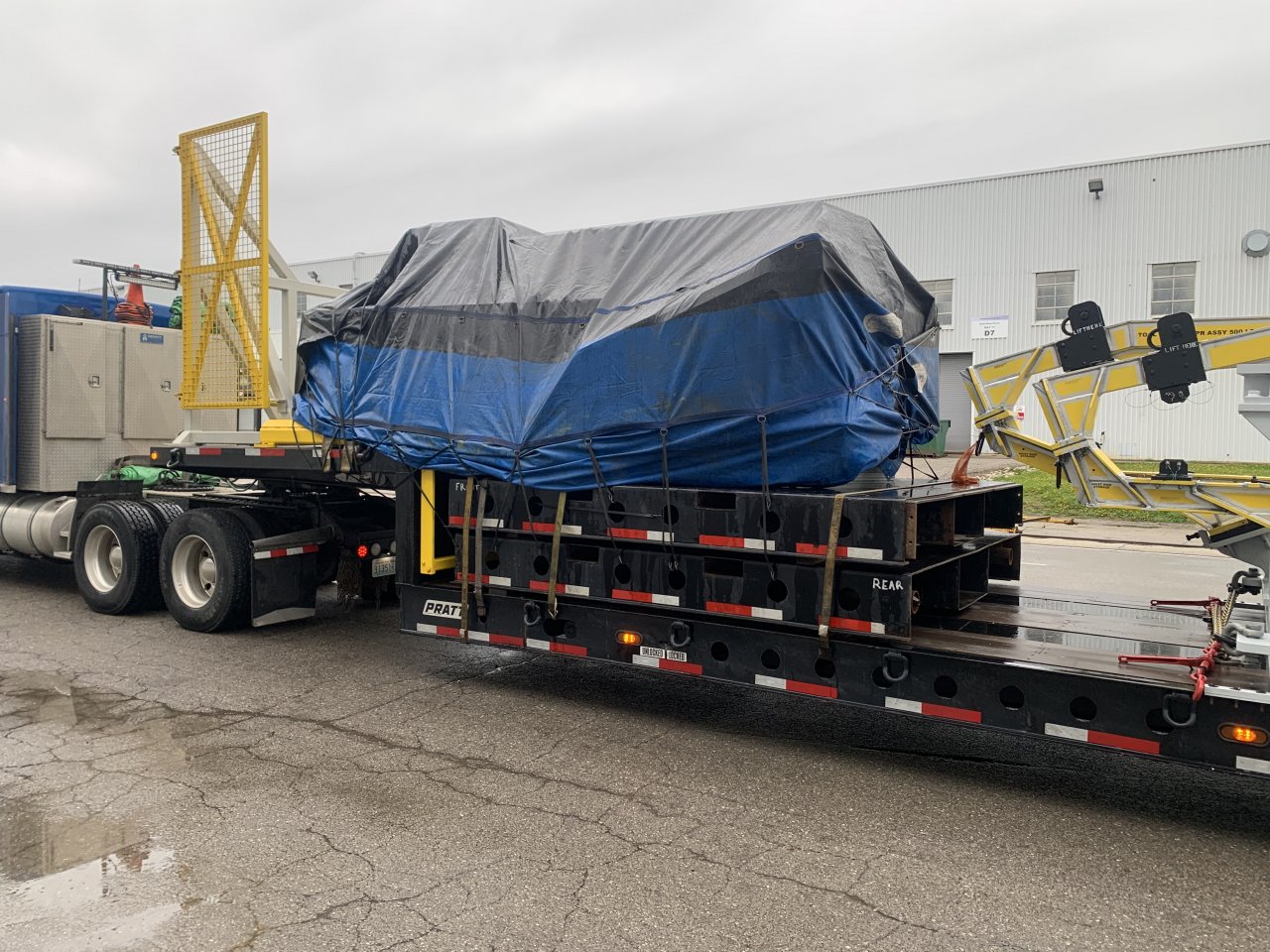

    Ya gotta live a little, unless I need to load my front axle for an over weight permit, my fifth wheel is Over the rear axle. I’m 13900on the front axle bobtail when full of fuel. 1BF5CF5D-7247-4685-91A1-9839D8087501.jpeg 8D61B588-B6D2-4913-9213-836FB61E07D7.jpeg 0E0E9E62-F26D-49EF-A8D7-87E24AABED3F.jpeg 85C7D08A-BC98-4309-9353-40A743D05CA9.jpeg
