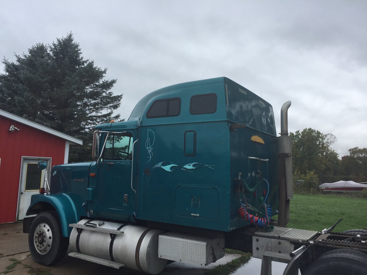

    B25D822A-8AED-4BCE-A364-1CD29AE4597B.jpeg B25D822A-8AED-4BCE-A364-1CD29AE4597B.jpeg Moved out of my house in Florida and had my boat and all my shop stuff brought up to Michigan on a step deck a few months back.
    My good buddy was nice enough to let me cram everything in his shop until we could deal with it when the weather cleared up, if that ever happens.
    So rather than move all my stuff again I was thinking of buying a 12 foot van body and rigging it to slide on and off the back of my bobtail.
    I was thinking some heavy duty legs I could pin on it when I want to offload it.
    Drop the air and pull out from under it.
    I don’t want a whole nother trailer and the eyesore and upkeep. I am limited to a 12 foot box because I want my semi to fit in
    The pole barn storage I have lined up
    Don’t quite know where I want to live hence the Mobil shop.
    I found a van body with a lift gate that I thought was perfect but it is 14 so I would have to shorten it.
    Than again I was thinking shipping containers. What size do those come in.
    All ideas and advice welcome. Just don’t want to move pack and move my shop again and again
