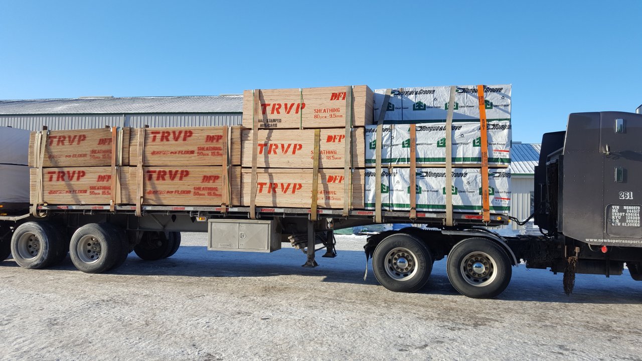

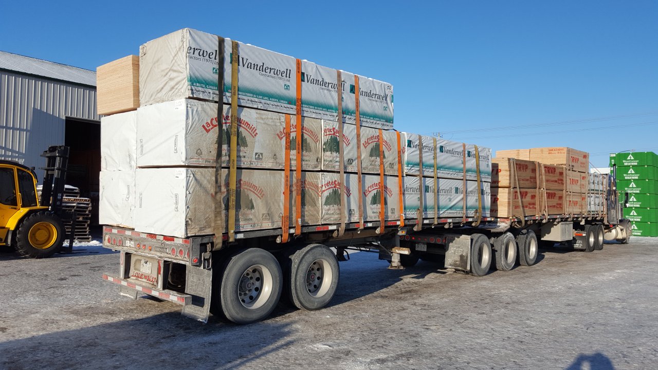

    Fool proof method:
    1. One strap per 4 feet of lift (i.e. 16 foot lifts need 4 straps)
    2. Extra strap on anything not blocked against forward movement (i.e. 12 foot lifts at front get 4)
    3. Standard lifts are "about 3 feet" tall, anything over two lifts high (6 feet) needs one belly strap per 8 feet of lift
    4. Piece of dunnage under front or back of lift if "one by's" (i.e. 1x4) to prevent sliding

    Said it before, I'll say it again. That file is golden. Use it weekly, study it daily.

    Well, I guess it isn't completely fool proof, it still requires the driver be able to count, throw a strap and crank a snipe bar.
    In all seriousness, it goes above and beyond the bare minimum required in the Green Bible in terms of aggregate working load limit coverage, and is nice and simple in terms of math. No need to figure out lift weight. Even 3,500 lb lifts of 8-foot OSB still end up fully covered -> ex. a stack of 4 lifts of OSB have an AWLL of 7,000 lbs, two 5,400 lb straps used indirectly is 10,800 lbs, three straps on ones not blocked against forward movement is 16,200, more than they weigh.
