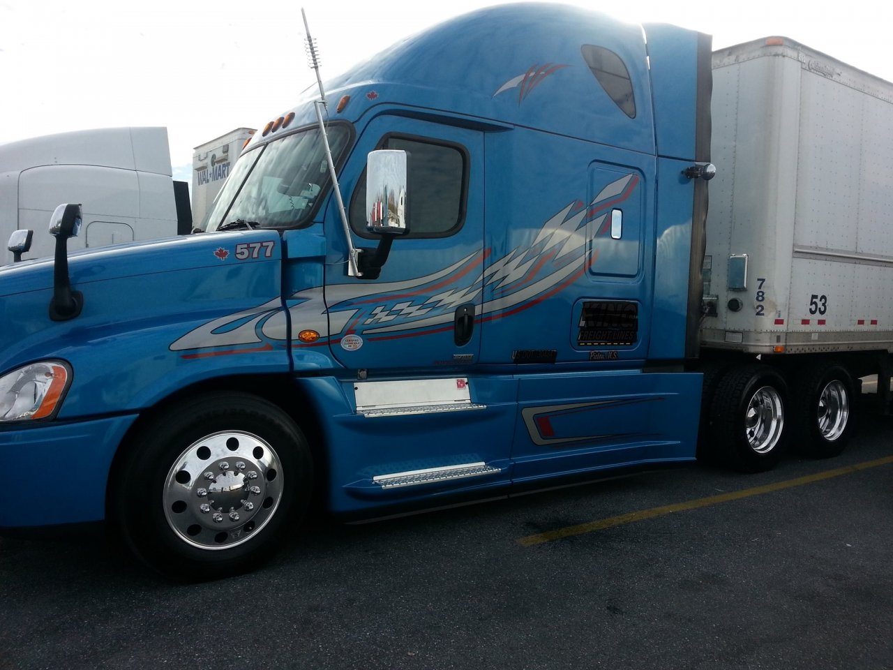

  7. craig_sez
    craig_sez Road Train Member
    5,570
    2,714
    Sep 5, 2013
    novascotia,Canada
    king freightliner.jpg Nope,doesnt work..Thats a dc ground if im correct and the ant system will look at that as a type of dipole if im correct..
    What rabbi will likely suggest is what many drivers will not be able to do cause of company rules about modding the truck..Goin through SAMMMEEEEE issues..Thought i had it solved with this..My analyzers shows all is good but noooo range..5-8 miles at best BUT i pick up tons of skip..
