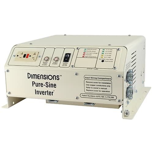

    And as for your squealing noise if you have a power inverter turn it off when you use your radio. My inverter causes interference with mine

  9. Slowmover1
    Slowmover1 Road Train Member
    1,491
    1,210
    Oct 25, 2015
    Fort Worth
    Samlex. And a few others. Brand really really matters with inverters.
    rabbiporkchop Thanks this.
