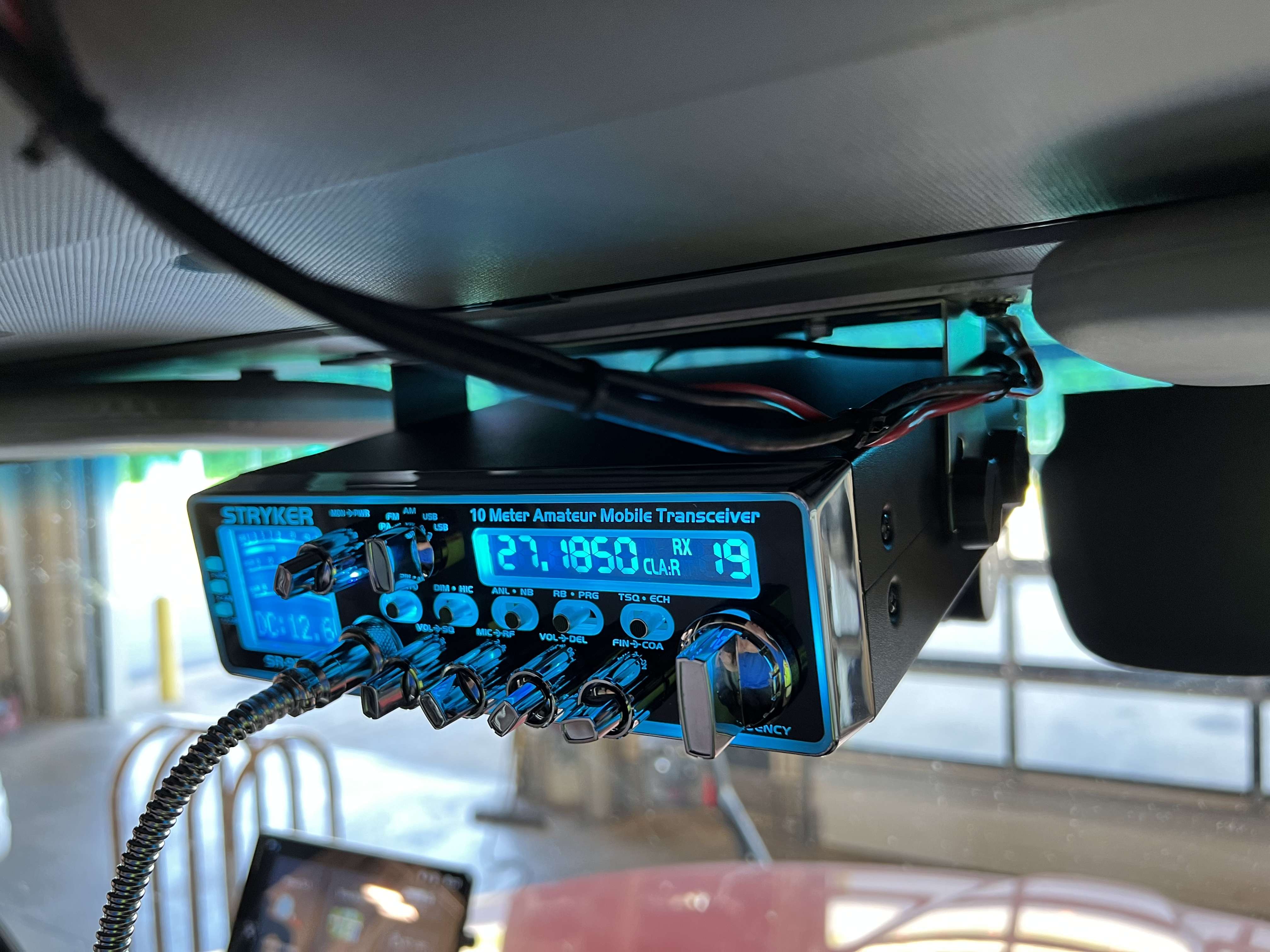

    Before being issued my truck, I had already decided that I wanted a Stryker radio and purchased one as soon as I found the model I wanted.
    As anyone knows who has been inside a T680, the CB slot will not accommodate anything larger than a small Cobra, such as the Stryker SR-447HPC. It was unbeknownst to me so upon discovering this I was quite dismayed. My employer will not allow any cutting or drilling so I was perplexed about what to do, short of spending several hundred more dollars on a smaller radio.
    Someone else suggested that I remove the center sunvisor and use the existing screws and holes to mount the radio. So, I removed the center sun visor only to discover the holes were farther apart than the entire width of my CB mounting bracket.
    While rolling up I-95 NB through Florence, SC on Saturday, I stopped at JB’s CB Shop next to the Petro and they were able to come up with a solution.
    Using an 11” piece of aluminum flat bar of 1/8” thick and self tapping screws the radio bracket was screwed down to the aluminum flat bar, and then the excess screw length was cut off so it wouldn’t be scarring the headliner. Once that was complete, the radio was mounted in place of the center sun visor. I used small zip ties to bunch up the cabling and keep it neat.
    When I get home in a couple weeks I will have the coax cut down to about 24” so that I don’t have a wad of cabling crammed into the CB slot. It isn’t hurting anything but I’m a stickler for details and sloppiness like that bothers me.
    I also got the Stryker SR-A10 antenna mounted and I couldn’t be happier.
    I’m pushing 80w with a 1.3 SWR using a single 10” shaft. I tried using the additional 10” to see if it would lower the SWR a little more but it actually raised it a little so I removed it.

    Looks good. If I were you I'd save the existing coax and have your desired 24" cable produced separately. Just in case ;-)

    That is a good suggestion and I will take your advice.
    I have no idea what kind of coax was used when the factory wired the truck but I’d I had my way about it, it would be stripped out and replaced with the best available. My transmit & receive are great but I tend to follow the idea of buy once, cry once. So, I like to do things right.
    Be that as it may, I’ll buy good coax to make the 24” length from. I realize it won’t make a difference but it looks better and makes me feel better as well.
