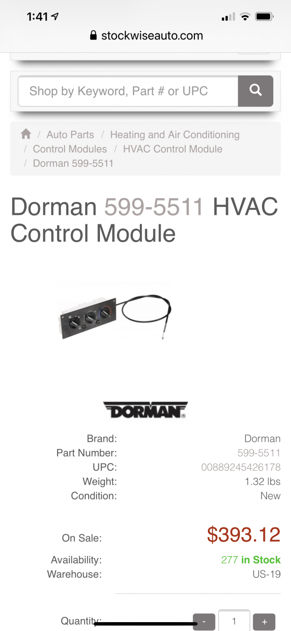

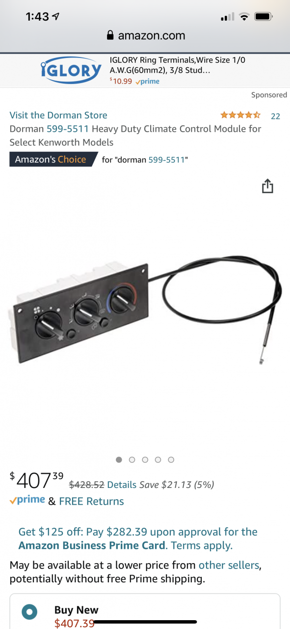

  8. Banker
    Banker Road Train Member
    4,549
    14,850
    Aug 19, 2012
    They are all over the board as far as price. If you are able to dig a little and cross reference some numbers you probably will be ok. 6237D6DE-B754-46B3-BE1A-73809A8F6F15.png 0104813E-438C-45D4-AF2A-8E08EB4F90F3.png
  9. Wheels65
    Wheels65 Bobtail Member
    6
    1
    Mar 8, 2021
    That’s not the module I have in my truck but I have been looking around and found a couple used ones for around $500 though.
