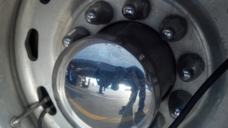

    My truck is needing new brakes, s-cams, and s-cam bushings. I have to pull the hub off to do this so I am going to do bearings as well. My truck currently has stud piloted wheels. Since I am in the market for some new rims and tires would it be worth it to buy new hubs and rims and converting it over to a hub pilot wheel? Are there any advantages between the two or would it just be wasted money? Thanks in advance!

    I have been calling around to see how much the new hub cost and no one knows what type I need. One shop told me that many Con-Met hubs were interchangeable, you just have to change the studs over. I have Con-Met hubs (part #cm 102314 or newer # 10001348 ) how does one tell if my hubs are interchangeable?

    The more I research what that parts guy told me the more I think he is full of poop. :) I think he just didn't have an answer to hub I need and told me I could swap studs. Thanks for the help everyone. God Bless!
