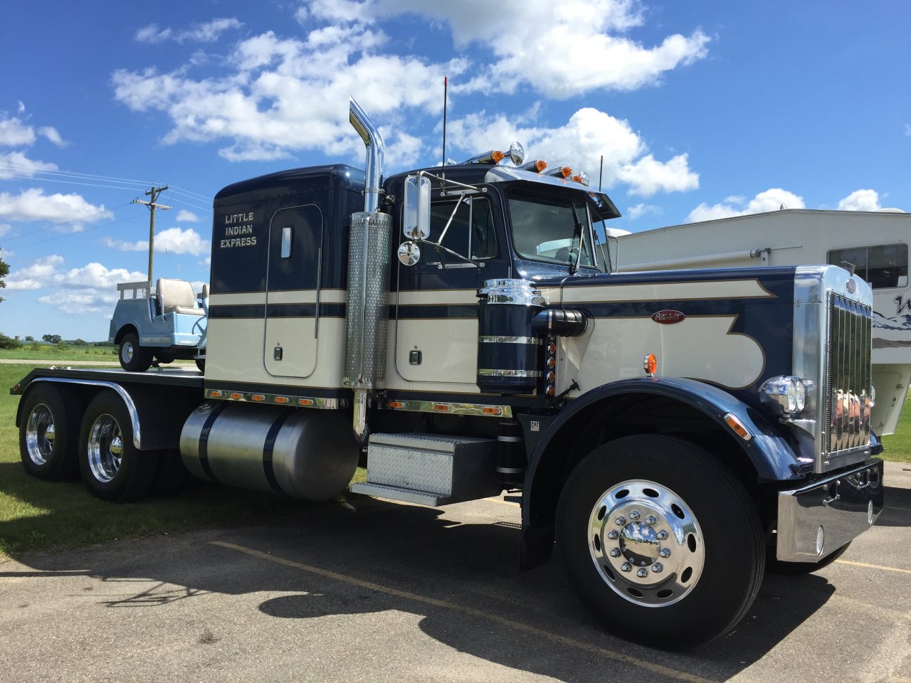

  9. beemergary
    beemergary Light Load Member
    229
    112
    Apr 11, 2014
    Iam keeping this ride.
