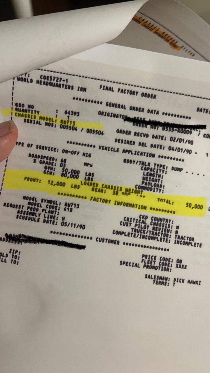

    IMG_4820.jpeg How’s it going fellow drivers, I just received my build sheets for my
    1990 Mack Superliner 713
    E7 400
    13sp road ranger
    Wanting to haul end dump this year
    Can anyone help me understand the build sheet? Seems to say 12k fronts 19s outback for a total of 50k. Does that mean I can only haul 50k? Seems light to me here in Indiana a tractor/24’ trailer can scale out at 73230.
  3. AModelCat
    29,724
    165,062
    The truck itself is built to haul 50k lbs by itself. A trailer increases that amount.

  4. JbugBDT
    JbugBDT Light Load Member
    57
    30
    Apr 26, 2024
    Northern Indiana
    That’s what I thought at first but my mind seems to overthink everything lol
  5. AModelCat
    29,724
    165,062
    I shouldn't have said a trailer increases it, more like a trailer adds to it.
  6. JbugBDT
    57
    30
    Apr 26, 2024
    Northern Indiana
    I know I have to look at the bridge law to see how much I can carry legally. I just wanted to make sure the truck could handle that weight
  7. ElmerFudpucker
    7,092
    77,636
    May 17, 2024
    You are not going to know that until you hook a trailer and scale it out.
