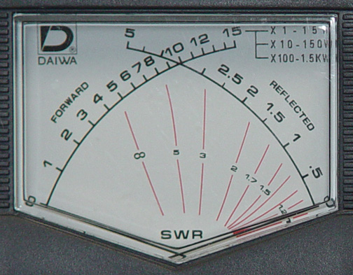

    $89.95
    The Diamond SX20C is a compact SWR-power meter. Featuring cross needle design for measuring SWR and output power simultaneously. Compact size makes it very useful for testing mobiles as well as base station installation.
    Special Features: • Cross needle design
    Rated from 3.5-30, 50-54, and 130-150 MHz
    Power ranges of 30 & 300 Watts
    http://www.hamradio.com/detail.cfm?pid=H0-000010
    I use this one and have found it accurate on average and PEP scales:
    $99.99
    DAIWA CN-101
    1.8-150MHz PEP WATTMETER/SWR SWR and Power indicators are installed in one meter unit.One scale will be indicated at the crossing point of the 2 needles. This unique feature makes it possible to read all of Forward Power, Reflected Power and SWR at the same time. 15/150/1500W scales.
    http://www.hamradio.com/detail.cfm?pid=H0-003409
    These are cross-needle scales and so there is no fiddling with a knob, it reads directly in forward and reverse power, and where the two needles cross, the SWR is visible. The SX-20C is small enough to put permanently on the dash in some cases.
    $89.95
    This one is a traditional meter with a knob and fwd-rev switch:
    Diamond SX200 Power Meter
    The SX200 measures forward and reflected power and VSWR. Compact size makes meter useful for testing both base and mobile installations.
    Special Features:
    Illuminated meter
    Switchable r.m.s. or peak power
    Measures forward, reflected & VSWR power
    6"W x 2"H x 4"D, 2 lbs.
    Specifications:
    Frequency: 1.8-200 MHz
    Power Ranges: 5/20/200
    Connector: SO-239
    Min. Power SWR Test:: 4W
    http://www.hamradio.com/detail.cfm?pid=H0-000009
    ->Most ham type meters like this need at least 4W to be accurate with SWR readings. Notice though that they have a wider frequency range than most CB-type meters and because they are for ham use are supposed to be accurate. Just saying before you spend $89 on a Dosy or Workman.. try a meter designed for better performance and accuracy.
    One thing to look at is whatever meter you buy ought to include a low power scale on it for CB use otherwise when using just a 4 watt CB radio the needle won't move much.
    I'm not pushing these brands, there are others as well. Anything costing less than $50-80 is probably not a very good meter. The days of a high quality $20 meter are gone with the 1970's.
    The picture shows how a cross-needle meter works. The forward and reflected needles both rise, and where they cross over a red line shows the SWR. Ideally the reflected needle stays down, for 1:1.
